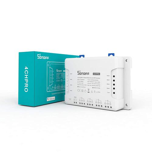

ESPHome can run on hardware like mentioned above and it has an independent irrigation scheduler that can operate without Home Assistant being available. I’ve been using it with the SONOFF 4 channel device for the past couple of years. Best of both worlds - you can make it run anyway you like with easy integration with Home Assistant, but rock solid reliability. There are several forum threads on how to achieve this.
