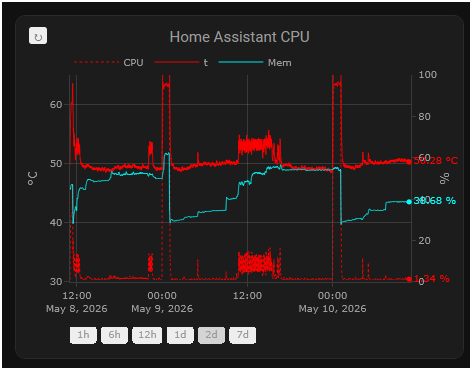

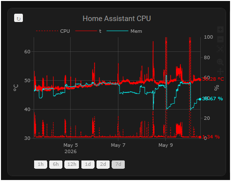

Strange CPU peak is now happening right at 00:)) for two days straight, as soon as I updated HA to 2026.5, and the next day to 2026.5.1
OS update was also installed with the 2026.05 version.
2 days
7 days
Two long peaks, about 1 hour long each, were only detected because PRi was too loud for too long, so I checked what was wrong.
Everything worked just fine, no critical errors, all responsive.
Peak usage goes back to normal as soon as I hit OS Reboot.
