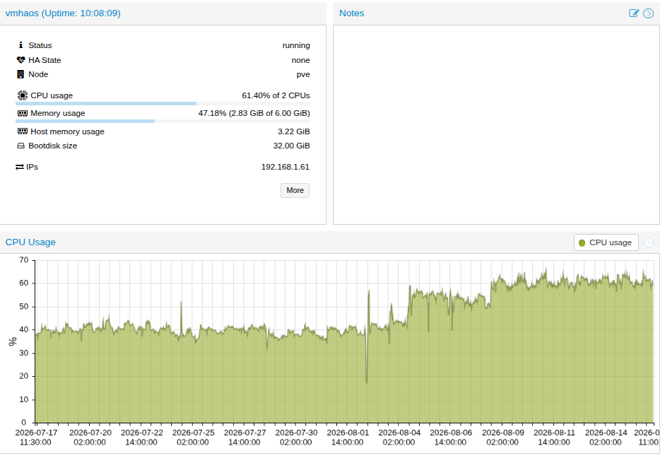

By now, it should be clear that preloading camera streams has nothing to do with the CPU load issue - precisely because the problem also affects users who haven’t integrated any cameras into HA at all. :slightly_smiling_face: In other words, the fact that some users experiencing this issue saw their load decrease after disabling stream preloading is likely just a coincidence. That is why you shouldn’t be surprised if disabling stream preloading doesn’t help in your case. :wink:
As previously mentioned, the increase in my case isn’t huge - meaning “only” from about 40% to around 60% CPU usage - but the rise following the update from Core 2026.7.4 to Core 2026.8.x in early August is clearly noticeable for me as well.
