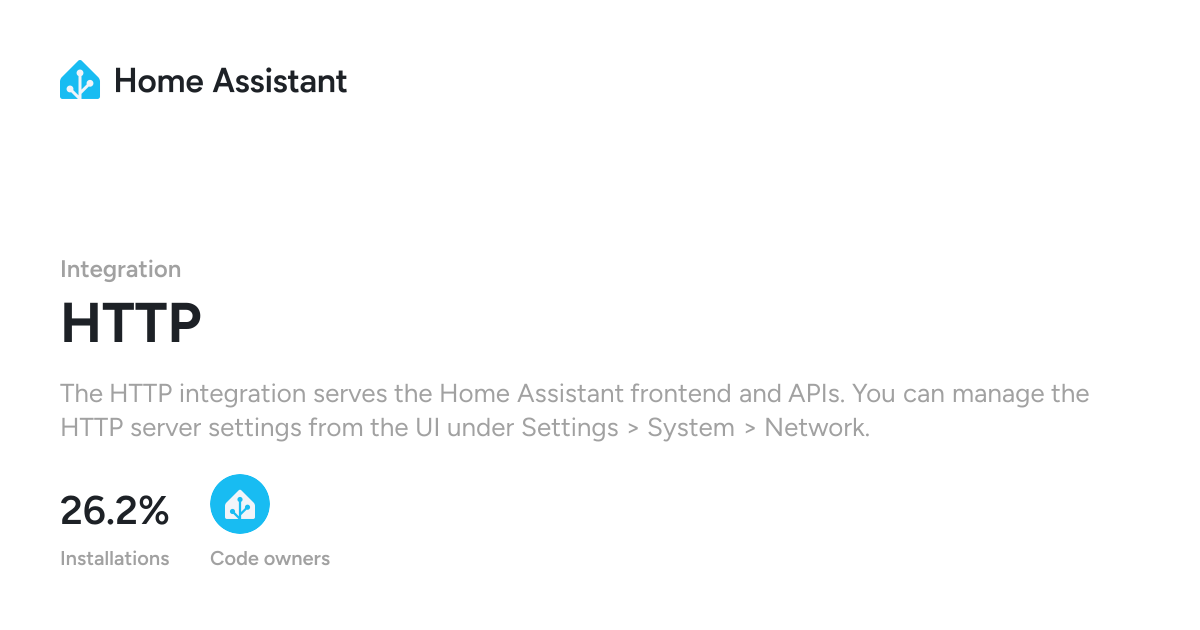

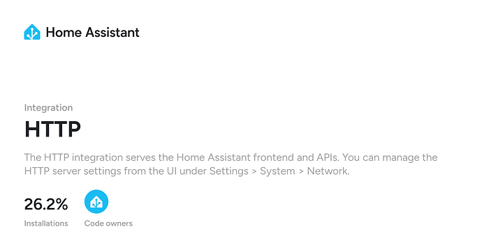

Related to this :up_arrow:
This post is more clear
You cannot trust a network that you are using in any trusted_proxies. The trusted_networks authentication will fail with the message: Your computer is not allowed
Those are auth_providers which are unrelated to the http integration & shouldn’t have been affected by the http migration.
In fact the documentation for those still tells you to set them up in yaml, so don’t delete that section - only delete the section under http:
