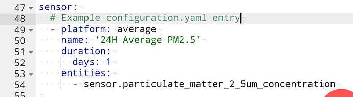

Now, I tried to add a 24h average sensor for it. I installed Average Sensor from HACS and added the sensor to my HA config.yaml.
It came up and seems to work fine, but then I noticed this: During the time I was away from home, the sensor value went down to 10. Average was 70. The average should be dropping hard, but strangely enough, it stays sortoff stable. And then hours later, it starts dropping off hard, while the primary sensor value has remained relatively constant all that time.
Am I overseeing something? Or misunderstanding the use of the ‘Average Sensor’?
