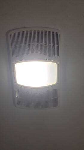

Can you post a photo of the light, fan and heater they connect to, including a rating label of the heater if one is visible on the side, or at least the make and model.

Image of light, fan, and heater unit included.

A reverse image search on Google lens shows this unit:
If so, it requires 1500watts power for the heater, plus a tiny bit more for the light and fan.
Check if the Moes switch will drive it. 1600watts at 110volts is around 15amps draw. (Ohm’s law with rounding)
Your electrician will be able to confirm if a neutral is present at the back of your existing switch and if the Moes unit (often only rated at 10amps and needing a neutral connection) is suitable.
Your other choice is to have the Moes switch for the heater to drive a contactor/relay to act as a ‘current booster’ to switch the appropriate current. You can even fit it out of the way in the ceiling space adjacent to the heater, rather than try and shoehorn things behind the switch. The power requirement for the light and fan should be less than 200watts each (under 2amps) so usually switches rated for lights (around 2-3amps) should be suitable. This way you could re-use your existing wiring without having to pull out and run new wires in the wall.

Often bathroom ceiling combo units are fitted aftermarket, so the existing light circuit power supply to the light switch is lazily repurposed to power the fan and heater also instead of coming from a suitably fused and rated power circuit. Hence no markings on the electrical board and no certainity the fuse rating is still appropriate, or the isolator switch for power is actually switching off the heater circuit if the lights remain powered.

All likely situations, based on my experiences in examining demolitions, collapses, and fire damaged dwellings. It is amazing what a bit of drywall can hide. The spiderwebs in the photo confirm this is not a recent installation.
The ceiling units often have half turn mounting toggle bolts and if heavy it can fall on you as you take it down, or be unexpectedly lopsided if balancing on a kitchen chair instead of a stable platform. Depending on how long the wires are and how well the connectors were tightened, you could have a swinging object hit you on the head or knock you sideways. All units come with fitting instructions, but I don’t recall seeing any removal instructions, ever.
