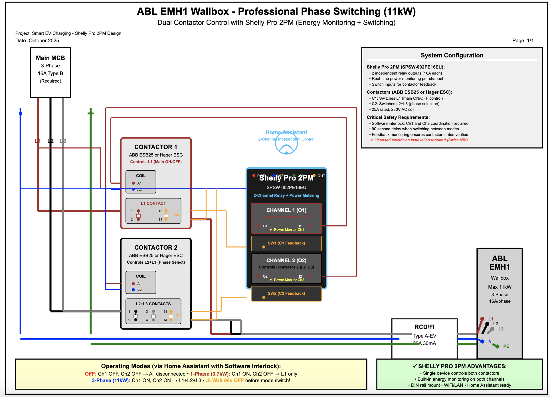

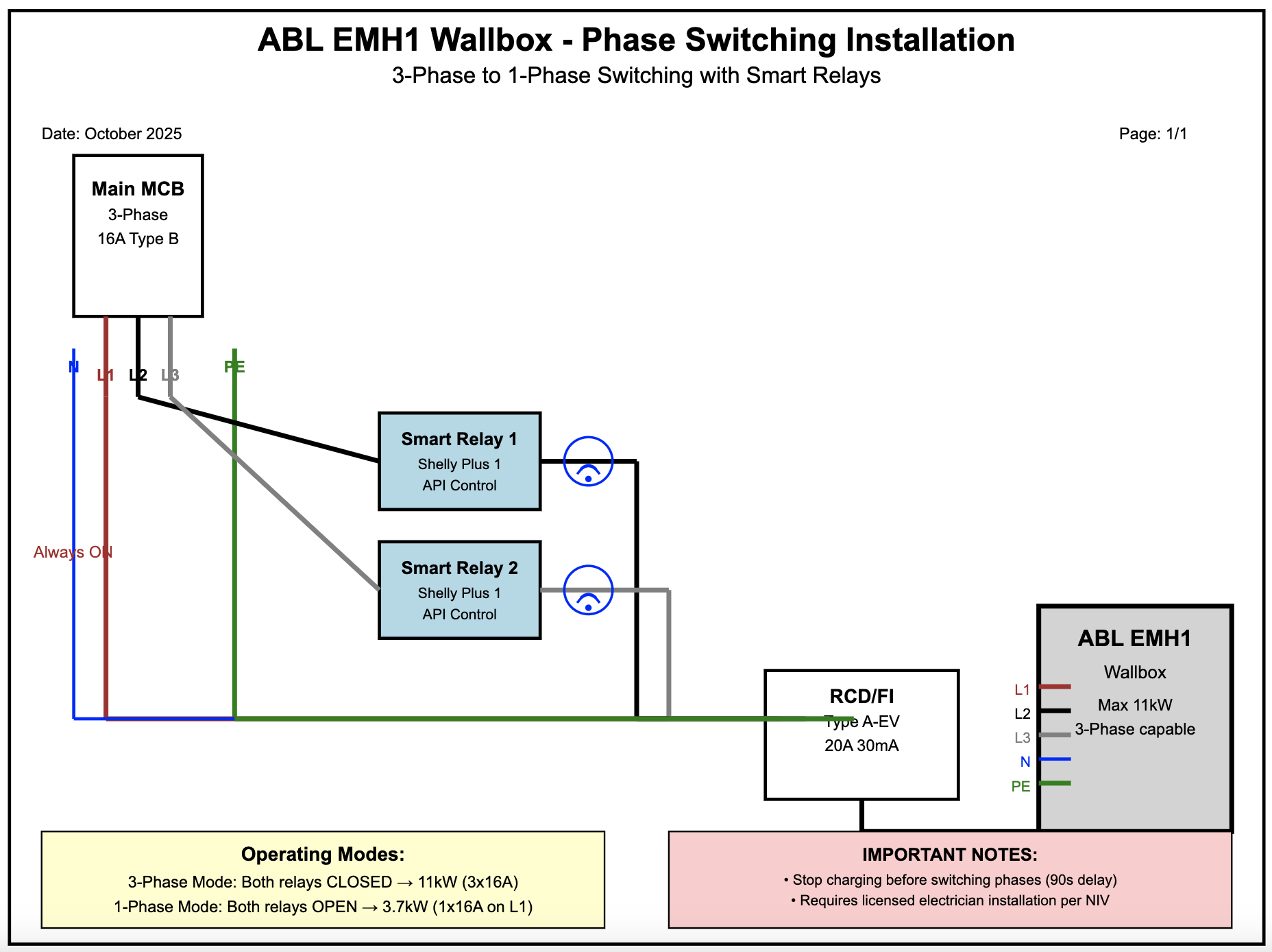

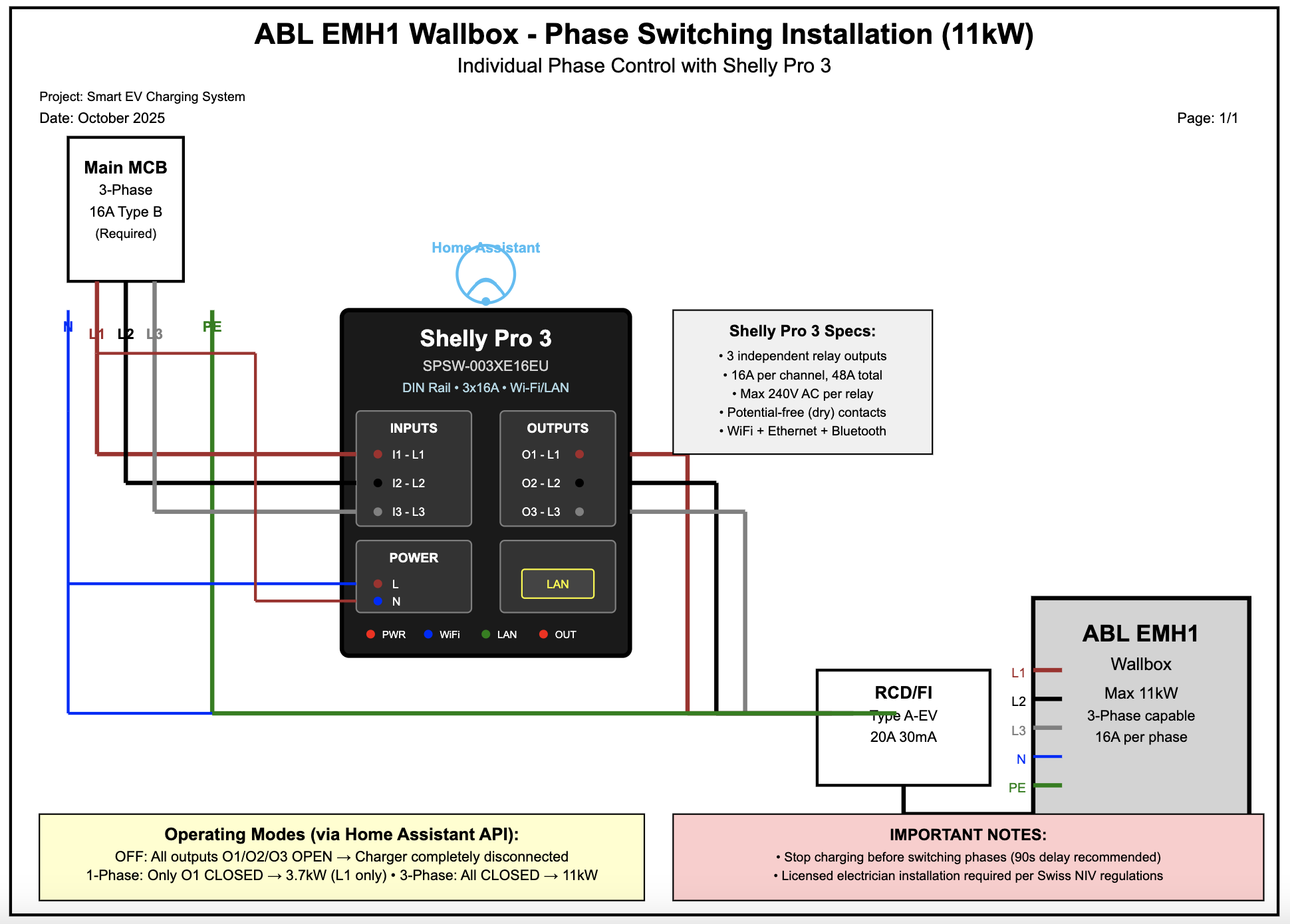

Here is what I want to achieve, but I would need the main MCB to be triggered by Homeassistant:

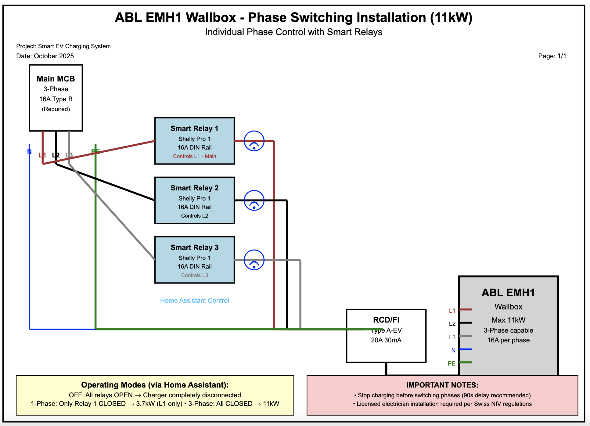

Or I try this, 3 shelly switch:
Or 1 Shelly 3 pro, but is this possible with it?

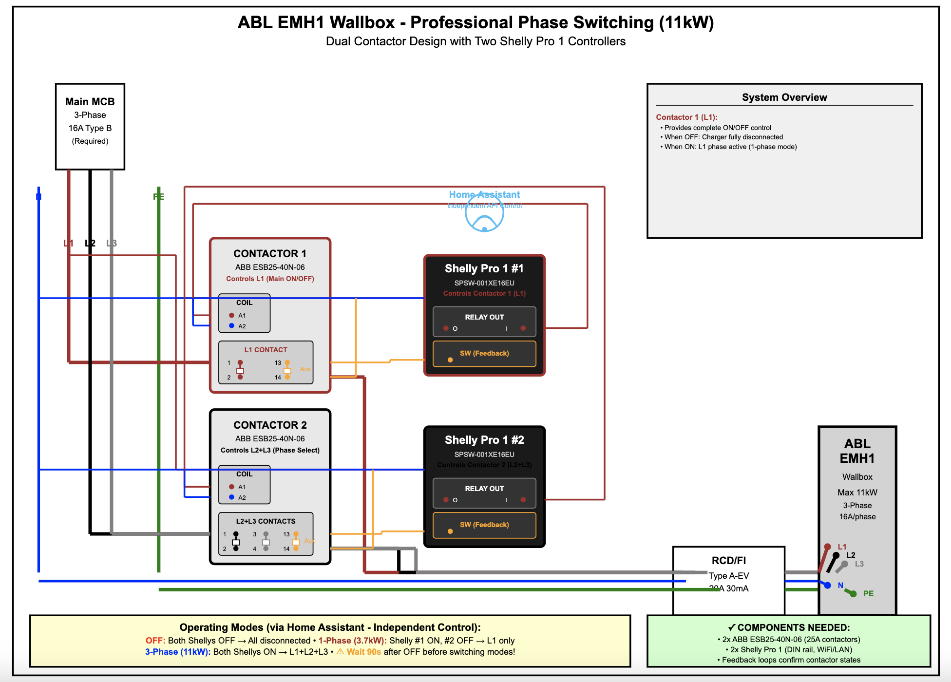

Hi

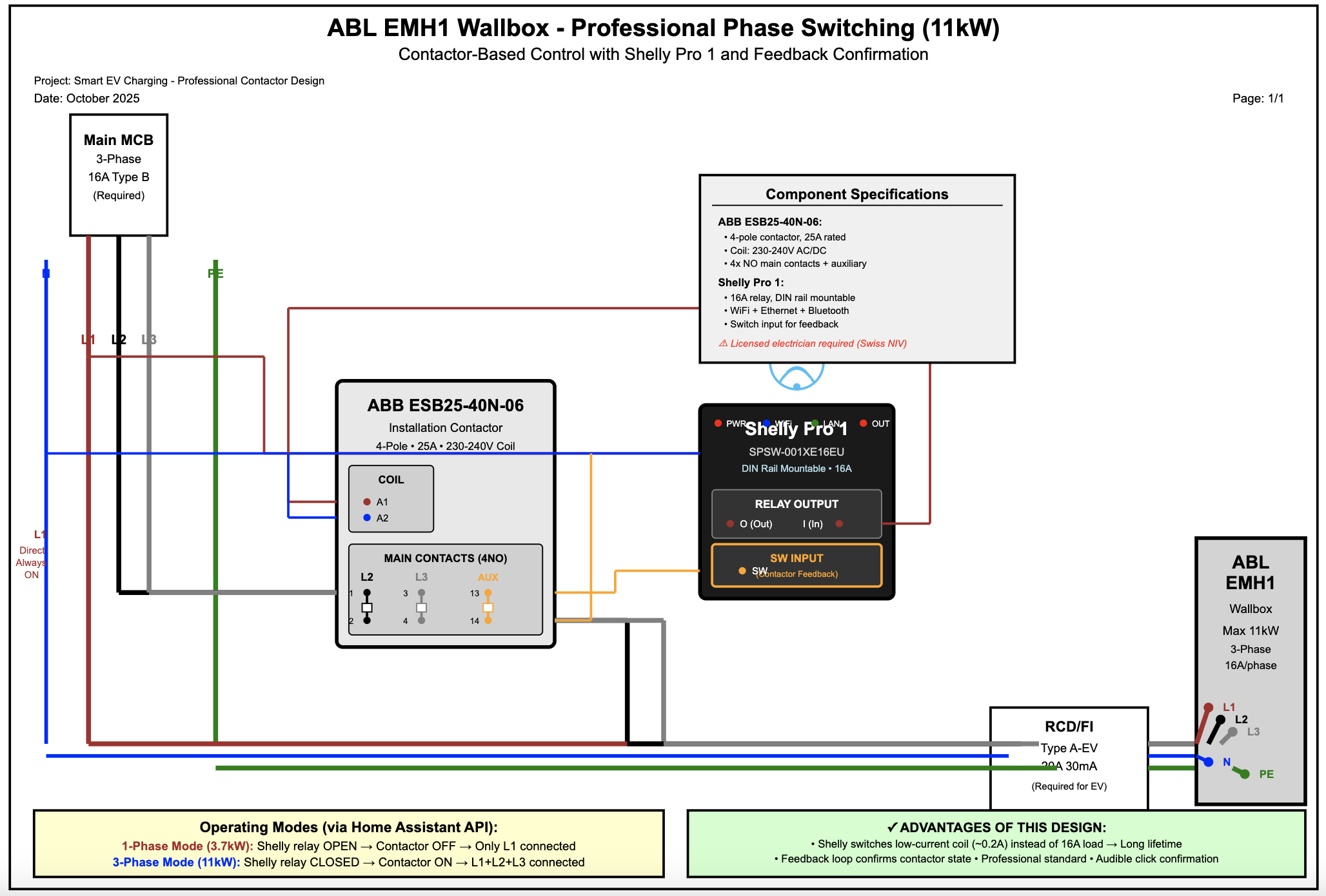

I’d go for variant 1.
But: Use a Shelly (Pro) 1 to switch a contactor like this: ABB ESB25-40N-06 - Schütz - Weiß - IP20 - AC - 36 mm - 65 mm - Installation Cont – Conrad Electronic Schweiz
Where you wire L2/L3 and don’t use the Shelly to switch the load directly.
You can also use one of the free closing contacts to wire the signal “contactor closed” back to the Shelly SW as a confirmation that nothing is defective.
Thanks so much!!

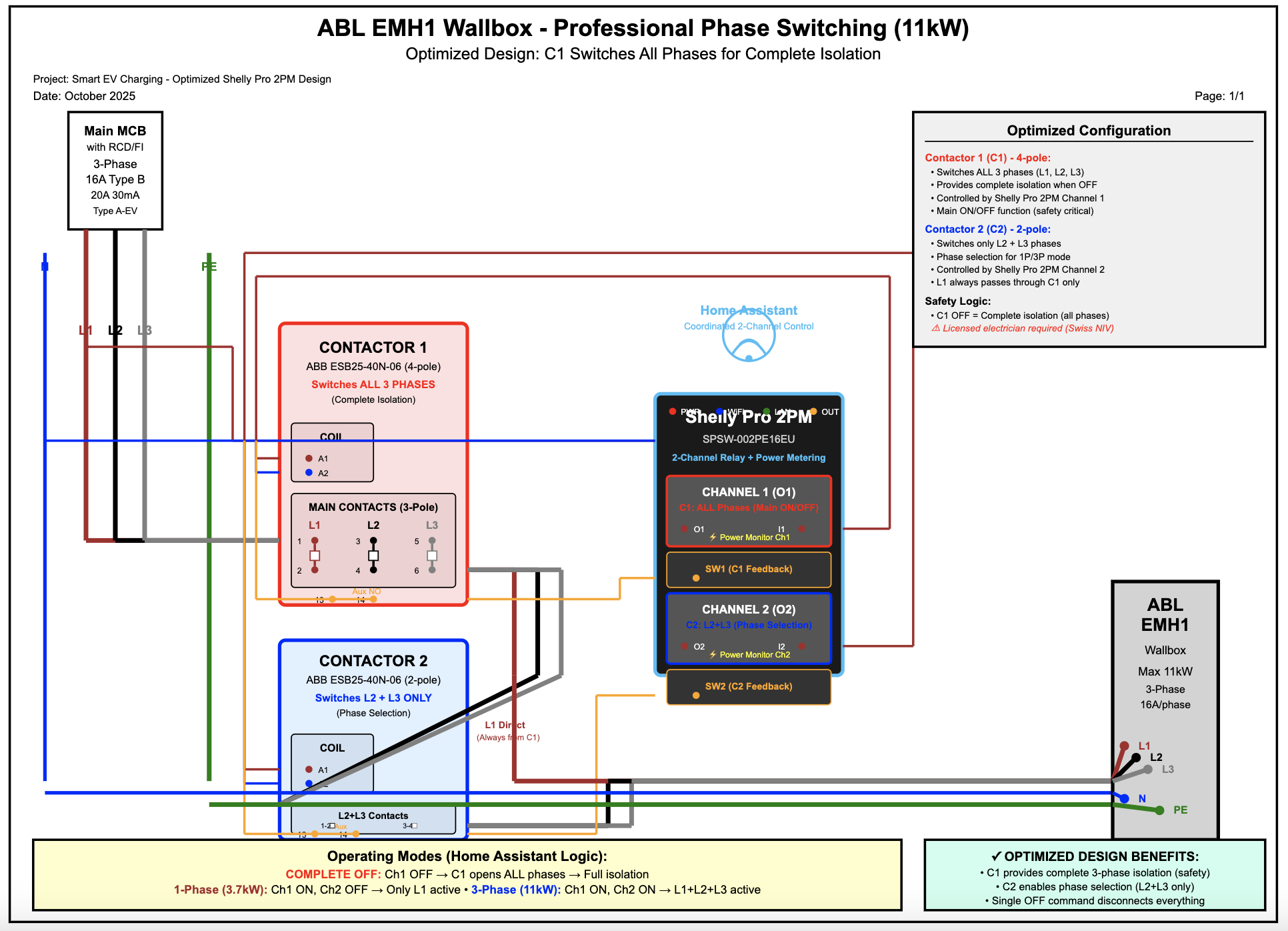

I believe this makes it look like this:

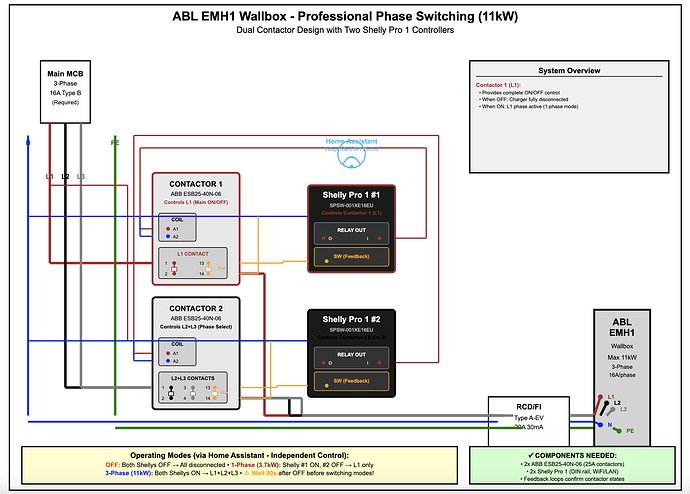

Well actually, i need to be able to switch everything off to switch phases, so to my understanding i still need 2 contactors and 2 shelly devices…
Or wait…

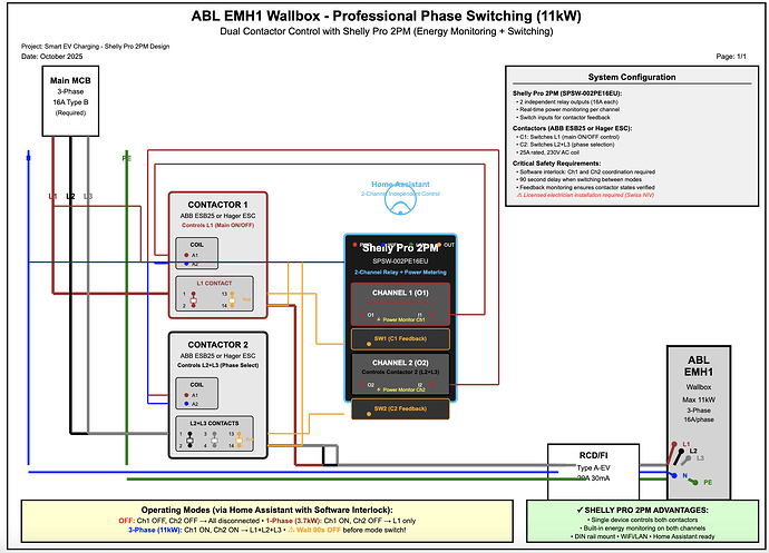

I believe the shelly 2PM enables a simpler solution:
So your load is 5A per phase. What is the reason not to go with plain Pro 3?
No, the load is 16A on 3 phases each maximum.
the reason for this setup is that I need to steer phase L1 and phase L2-L3 separately. When running on 3 phases, you run at 400volts 16A 3-phase current, when running L1 only, you are at 230v 16A 1-phase current.
I’m not sure the Pro 3 has everything required to run such a switch, hence my discussion topic. Playing with 3-phase current requires double attention and the shelly 3Pro is rated 230v and not 400v, so i doubt it’s possible.
To my understanding, the contactor gives you first the ability to not directly switch the load (safer?), enables higher load than the switch itself (would be a must if i would be running a 22kw charger on a 32A circuit) and enables “mechanical” simultaneous switch of 2 phases or 3 phases with a single phase switch.
Even improved a bit:
Now the schematic is complete with:
Feedback Connections (Both Contactors):
Contactor 1 → Shelly Channel 1 (SW1):
  • Auxiliary contact 13-14 confirms C1 is actually closed
  • Feedback goes to SW1 input on Shelly Pro 2PM
Contactor 2 → Shelly Channel 2 (SW2):
  • Auxiliary contact 13-14 confirms C2 is actually closed
  • Feedback goes to SW2 input on Shelly Pro 2PM
Why Both Feedbacks Are Important:
  1. State Verification: Home Assistant knows the actual contactor states, not just what was commanded
  2. Fault Detection: If a contactor fails to close/open, the Shelly detects it immediately
  3. Safety Interlock: You can program logic to prevent switching if contactors don’t respond correctly
  4. Monitoring: Track contactor operations and detect wear/failure before it becomes critical
Now both contactors have proper feedback loops to the Shelly Pro 2PM, giving you complete monitoring and control! The schematic is functionally complete and ready for your electrician.
