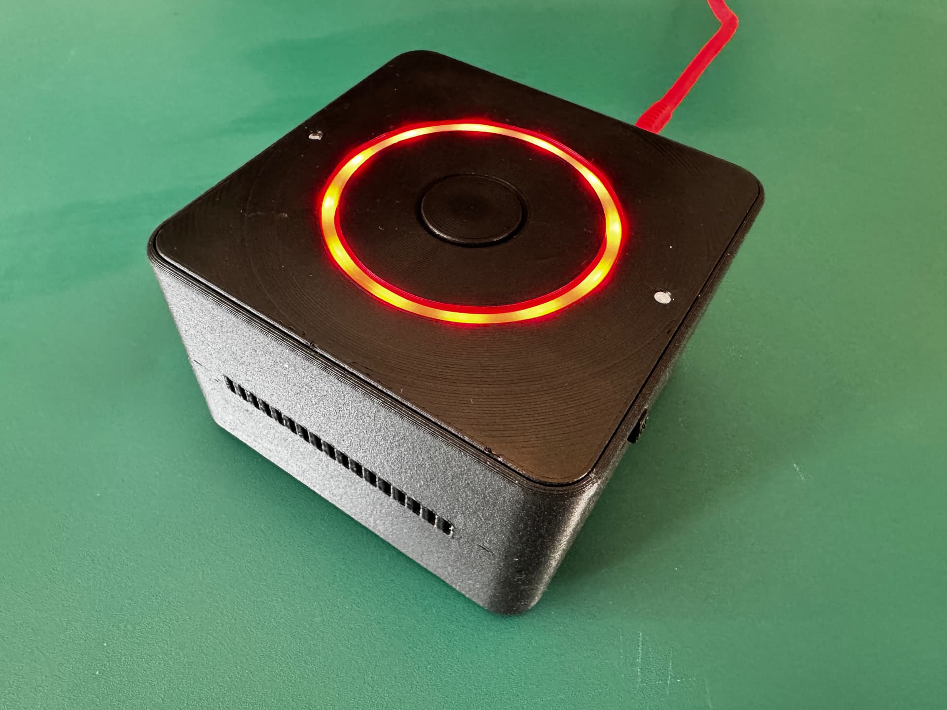

Yes, I was hoping some one had 3D printed case and could share drawings and files to 3D print. ![]()
I just printed this case for my PE, it includes space for an upgraded 40mm speaker and additional vents to allow the sound out of more than just the front hole. The case is really nicely designed, adds a slight upgrade to the sound quality and volume and I was able to salvage the speaker from an old echo dot which is very satisfying ![]()
How did you power the speaker with the same USB-C cable as the Voice Assistant PE?
I just desoldering the connector from the old speaker and attached to the new speaker
