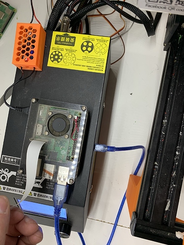

I have a CR10 - Mini that I control with Octoprint running on a PI3 B+ The Pi is powered from the printers Power supply via a LM2596 buck converter. I have a Shelly 1 switching the main power to the printer,

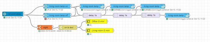

The automated shutdown flow looks like this and if im not home or if is later than 22:00 it shuts down the printer after 5min, also if not home I get a simple email about it. I will try to add a picture from the pi cam to the email at some point. If im at home i have a 20 min timer in case I want to start a new print right away.
Just because its possible My google homes announces that the print is done and it blinks my Livingroom ceiling lamp

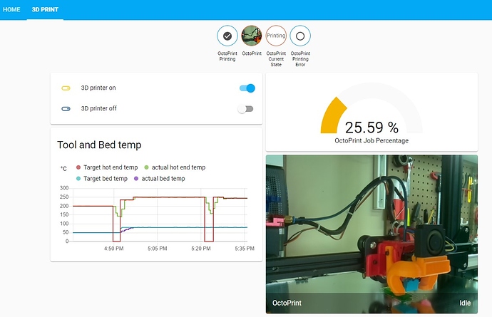

In Home Assistant there is a simple view to show some information
Im certain that this can be done more elegant but it does work very well.
if someone is interested here is the Node Red flow
[{"id":"7428b3a1.32108c","type":"tab","label":"3D Print Done","disabled":false,"info":"When octo print changes status on binary sensor for printing \noffice lamp blinks \nlivingroom lamp blinks \nif no new print started in 15 min turn power off (to be set up)"},{"id":"829b4668.3b50c8","type":"server-state-changed","z":"7428b3a1.32108c","name":"3D print done","server":"ad021f45.a359d","version":1,"exposeToHomeAssistant":false,"haConfig":[{"property":"name","value":""},{"property":"icon","value":""}],"entityidfilter":" binary_sensor.octoprint_printing","entityidfiltertype":"substring","outputinitially":false,"state_type":"str","haltifstate":"on","halt_if_type":"str","halt_if_compare":"is","outputs":2,"output_only_on_state_change":true,"for":"","forType":"num","forUnits":"minutes","ignorePrevStateNull":false,"ignorePrevStateUnknown":false,"ignorePrevStateUnavailable":false,"ignoreCurrentStateUnknown":false,"ignoreCurrentStateUnavailable":false,"x":119,"y":131,"wires":[[],["8b451685.f2dd08","f2547c81.7359","989cec39.9de1c"]]},{"id":"18635730.208fb9","type":"api-call-service","z":"7428b3a1.32108c","name":"living room lamp","server":"ad021f45.a359d","version":1,"debugenabled":false,"service_domain":"homeassistant","service":"toggle","entityId":"switch.livingroom_lamp","data":"","dataType":"json","mergecontext":"","output_location":"payload","output_location_type":"msg","mustacheAltTags":false,"x":640,"y":80,"wires":[[]]},{"id":"59c2db31.4e80a4","type":"api-call-service","z":"7428b3a1.32108c","name":"living room lamp","server":"ad021f45.a359d","version":1,"debugenabled":false,"service_domain":"homeassistant","service":"toggle","entityId":"switch.livingroom_lamp","data":"","dataType":"json","mergecontext":"","output_location":"payload","output_location_type":"msg","mustacheAltTags":false,"x":840,"y":80,"wires":[[]]},{"id":"5fb5cef6.ab3bf","type":"api-call-service","z":"7428b3a1.32108c","name":"living room lamp","server":"ad021f45.a359d","version":"1","debugenabled":false,"service_domain":"homeassistant","service":"toggle","entityId":"switch.livingroom_lamp","data":"","dataType":"json","mergecontext":"","output_location":"payload","output_location_type":"msg","mustacheAltTags":false,"x":1040,"y":80,"wires":[[]]},{"id":"be6a4a52.e8b4a8","type":"api-call-service","z":"7428b3a1.32108c","name":"living room lamp","server":"ad021f45.a359d","version":1,"debugenabled":false,"service_domain":"homeassistant","service":"toggle","entityId":"switch.livingroom_lamp","data":"","dataType":"json","mergecontext":"","output_location":"payload","output_location_type":"msg","mustacheAltTags":false,"x":1200,"y":140,"wires":[[]]},{"id":"4e26e3e3.9a299c","type":"delay","z":"7428b3a1.32108c","name":"","pauseType":"delay","timeout":"1","timeoutUnits":"seconds","rate":"1","nbRateUnits":"1","rateUnits":"second","randomFirst":"1","randomLast":"5","randomUnits":"seconds","drop":false,"x":840,"y":140,"wires":[["5fb5cef6.ab3bf","c2fd9d74.b635e"]]},{"id":"39fa9cc4.2fcbd4","type":"delay","z":"7428b3a1.32108c","name":"","pauseType":"delay","timeout":"1","timeoutUnits":"seconds","rate":"1","nbRateUnits":"1","rateUnits":"second","randomFirst":"1","randomLast":"5","randomUnits":"seconds","drop":false,"x":640,"y":140,"wires":[["59c2db31.4e80a4","4e26e3e3.9a299c"]]},{"id":"c2fd9d74.b635e","type":"delay","z":"7428b3a1.32108c","name":"","pauseType":"delay","timeout":"1","timeoutUnits":"seconds","rate":"1","nbRateUnits":"1","rateUnits":"second","randomFirst":"1","randomLast":"5","randomUnits":"seconds","drop":false,"x":1026,"y":139,"wires":[["be6a4a52.e8b4a8"]]},{"id":"8b451685.f2dd08","type":"api-current-state","z":"7428b3a1.32108c","name":"living room lamp on","server":"ad021f45.a359d","version":"1","outputs":2,"halt_if":"off","halt_if_type":"str","halt_if_compare":"is","override_topic":true,"entity_id":"switch.livingroom_lamp","state_type":"str","state_location":"payload","override_payload":"msg","entity_location":"data","override_data":"msg","blockInputOverrides":false,"x":410,"y":80,"wires":[[],["18635730.208fb9","39fa9cc4.2fcbd4"]]},{"id":"f2547c81.7359","type":"api-current-state","z":"7428b3a1.32108c","name":"living room lamp off","server":"ad021f45.a359d","version":"1","outputs":2,"halt_if":"on","halt_if_type":"str","halt_if_compare":"is","override_topic":true,"entity_id":"switch.livingroom_lamp","state_type":"str","state_location":"payload","override_payload":"msg","entity_location":"data","override_data":"msg","blockInputOverrides":false,"x":410,"y":140,"wires":[[],["39fa9cc4.2fcbd4","18635730.208fb9"]]},{"id":"60aec84.e178038","type":"server-state-changed","z":"7428b3a1.32108c","name":"3D print done","server":"ad021f45.a359d","version":1,"exposeToHomeAssistant":false,"haConfig":[{"property":"name","value":""},{"property":"icon","value":""}],"entityidfilter":"binary_sensor.octoprint_printing","entityidfiltertype":"substring","outputinitially":false,"state_type":"str","haltifstate":"on","halt_if_type":"str","halt_if_compare":"is","outputs":2,"output_only_on_state_change":true,"for":"","forType":"num","forUnits":"minutes","ignorePrevStateNull":false,"ignorePrevStateUnknown":false,"ignorePrevStateUnavailable":false,"ignoreCurrentStateUnknown":false,"ignoreCurrentStateUnavailable":false,"x":110,"y":520,"wires":[["99e0d653.eb8908"],["a4cac99e.d99948"]]},{"id":"17d445d8.c72b2a","type":"change","z":"7428b3a1.32108c","name":"on to text","rules":[{"t":"set","p":"payload","pt":"msg","to":"3D Print is done","tot":"str"}],"action":"","property":"","from":"","to":"","reg":false,"x":480,"y":220,"wires":[["61977ca1.bc8c34","eeffff9d.0ff95"]]},{"id":"61977ca1.bc8c34","type":"cast-to-client","z":"7428b3a1.32108c","name":"Living room G mini","url":"","contentType":"","message":"","language":"en","ip":"192.168.40.109","port":"","volume":"50","x":690,"y":240,"wires":[[]]},{"id":"989cec39.9de1c","type":"time-range-switch","z":"7428b3a1.32108c","name":"night","lat":"36.08999","lon":"-79.82967","startTime":"22:00","endTime":"06:30","startOffset":0,"endOffset":0,"x":330,"y":220,"wires":[[],["17d445d8.c72b2a"]]},{"id":"a4cac99e.d99948","type":"api-current-state","z":"7428b3a1.32108c","name":"Jesper Home","server":"ad021f45.a359d","version":1,"outputs":2,"halt_if":"home","halt_if_type":"str","halt_if_compare":"is","override_topic":true,"entity_id":"person.jesper","state_type":"str","state_location":"payload","override_payload":"msg","entity_location":"data","override_data":"msg","blockInputOverrides":false,"x":310,"y":520,"wires":[["a7bfd393.977cf","3dc0b487.e3e90c"],["f7a1f309.a2498"]]},{"id":"a7bfd393.977cf","type":"time-range-switch","z":"7428b3a1.32108c","name":"night","lat":"36.08999","lon":"-79.82967","startTime":"22:00","endTime":"06:30","startOffset":0,"endOffset":0,"x":570,"y":520,"wires":[["3dc0b487.e3e90c"],["9908c118.3d94a"]]},{"id":"ae774441.a66328","type":"inject","z":"7428b3a1.32108c","name":"","props":[{"p":"payload"},{"p":"topic","vt":"str"}],"repeat":"","crontab":"","once":false,"onceDelay":0.1,"topic":"on","payload":"","payloadType":"str","x":170,"y":1060,"wires":[[]]},{"id":"3dc0b487.e3e90c","type":"stoptimer","z":"7428b3a1.32108c","duration":"5","units":"Minute","payloadtype":"num","payloadval":"0","name":"","x":700,"y":460,"wires":[["32894459.7c4a8c"],[]]},{"id":"9908c118.3d94a","type":"stoptimer","z":"7428b3a1.32108c","duration":"20","units":"Minute","payloadtype":"num","payloadval":"0","name":"","x":700,"y":580,"wires":[["32894459.7c4a8c"],[]]},{"id":"99e0d653.eb8908","type":"change","z":"7428b3a1.32108c","name":"send stop","rules":[{"t":"set","p":"payload","pt":"msg","to":"stop","tot":"str"}],"action":"","property":"","from":"","to":"","reg":false,"x":320,"y":580,"wires":[["9908c118.3d94a","3dc0b487.e3e90c"]]},{"id":"d5aa65a6.c45c98","type":"e-mail","z":"7428b3a1.32108c","server":"smtp.gmail.com","port":"465","secure":true,"tls":true,"name":"[email protected]","dname":"Jeppe","x":510,"y":420,"wires":[]},{"id":"f7a1f309.a2498","type":"change","z":"7428b3a1.32108c","name":"on to text","rules":[{"t":"set","p":"payload","pt":"msg","to":"Hey, The 3D Print is done you should check it out when you get home ","tot":"str"}],"action":"","property":"","from":"","to":"","reg":false,"x":370,"y":420,"wires":[["d5aa65a6.c45c98"]]},{"id":"eeffff9d.0ff95","type":"cast-to-client","z":"7428b3a1.32108c","name":"Office G mini","url":"","contentType":"","message":"","language":"en","ip":"192.168.40.10","port":"","volume":"50","x":670,"y":180,"wires":[[]]},{"id":"32894459.7c4a8c","type":"api-call-service","z":"7428b3a1.32108c","name":"Octoprint Shutdown","server":"ad021f45.a359d","version":1,"debugenabled":false,"service_domain":"script","service":"octoprint_shutdown","entityId":"","data":"","dataType":"json","mergecontext":"","output_location":"","output_location_type":"none","mustacheAltTags":false,"x":930,"y":520,"wires":[["4bfe8b1a.5a2a04"]]},{"id":"3520f805.9e2de8","type":"api-call-service","z":"7428b3a1.32108c","name":"Printer Power","server":"ad021f45.a359d","version":1,"debugenabled":false,"service_domain":"light","service":"turn_off","entityId":"light.3d_printer","data":"","dataType":"json","mergecontext":"","output_location":"","output_location_type":"none","mustacheAltTags":false,"x":1220,"y":520,"wires":[["bfbe791f.d73318"]]},{"id":"4bfe8b1a.5a2a04","type":"stoptimer","z":"7428b3a1.32108c","duration":"1","units":"Minute","payloadtype":"num","payloadval":"0","name":"shut down delay timer","x":980,"y":620,"wires":[["3520f805.9e2de8"],[]]},{"id":"ec83a2d1.a7442","type":"server-state-changed","z":"7428b3a1.32108c","name":"Printer Turn On","server":"ad021f45.a359d","version":1,"exposeToHomeAssistant":false,"haConfig":[{"property":"name","value":""},{"property":"icon","value":""}],"entityidfilter":"input_boolean.3d_printer_on","entityidfiltertype":"exact","outputinitially":false,"state_type":"str","haltifstate":"on","halt_if_type":"str","halt_if_compare":"is","outputs":2,"output_only_on_state_change":true,"for":0,"forType":"num","forUnits":"minutes","ignorePrevStateNull":false,"ignorePrevStateUnknown":false,"ignorePrevStateUnavailable":false,"ignoreCurrentStateUnknown":false,"ignoreCurrentStateUnavailable":false,"x":120,"y":760,"wires":[["d2575c0.c5e5ba8","4485a003.7b2e"],[]]},{"id":"d2575c0.c5e5ba8","type":"api-current-state","z":"7428b3a1.32108c","name":"printing state","server":"ad021f45.a359d","version":1,"outputs":2,"halt_if":"on","halt_if_type":"str","halt_if_compare":"is","override_topic":false,"entity_id":"binary_sensor.octoprint_printing","state_type":"str","state_location":"payload","override_payload":"msg","entity_location":"data","override_data":"msg","blockInputOverrides":false,"x":330,"y":760,"wires":[[],["15ad3776.5bbdf9"]]},{"id":"15ad3776.5bbdf9","type":"api-call-service","z":"7428b3a1.32108c","name":"Printer Power On","server":"ad021f45.a359d","version":1,"debugenabled":false,"service_domain":"light","service":"turn_on","entityId":"light.3d_printer","data":"","dataType":"json","mergecontext":"","output_location":"","output_location_type":"none","mustacheAltTags":false,"x":550,"y":720,"wires":[["de29d8bc.b266a8"]]},{"id":"c6a1120b.517bf","type":"server-state-changed","z":"7428b3a1.32108c","name":"Printer Turn Off","server":"ad021f45.a359d","version":1,"exposeToHomeAssistant":false,"haConfig":[{"property":"name","value":""},{"property":"icon","value":""}],"entityidfilter":"input_boolean.3d_printer_off","entityidfiltertype":"exact","outputinitially":false,"state_type":"str","haltifstate":"on","halt_if_type":"str","halt_if_compare":"is","outputs":2,"output_only_on_state_change":true,"for":0,"forType":"num","forUnits":"minutes","ignorePrevStateNull":false,"ignorePrevStateUnknown":false,"ignorePrevStateUnavailable":false,"ignoreCurrentStateUnknown":false,"ignoreCurrentStateUnavailable":false,"x":120,"y":880,"wires":[["499442a6.dd81bc"],[]]},{"id":"499442a6.dd81bc","type":"api-current-state","z":"7428b3a1.32108c","name":"printing state","server":"ad021f45.a359d","version":1,"outputs":2,"halt_if":"on","halt_if_type":"str","halt_if_compare":"is","override_topic":false,"entity_id":"binary_sensor.octoprint_printing","state_type":"str","state_location":"payload","override_payload":"msg","entity_location":"data","override_data":"msg","blockInputOverrides":false,"x":330,"y":880,"wires":[["de29d8bc.b266a8"],["c6c118fe.3c5008"]]},{"id":"c6c118fe.3c5008","type":"api-call-service","z":"7428b3a1.32108c","name":"Octoprint Shutdown","server":"ad021f45.a359d","version":1,"debugenabled":false,"service_domain":"script","service":"octoprint_shutdown","entityId":"","data":"","dataType":"json","mergecontext":"","output_location":"","output_location_type":"none","mustacheAltTags":false,"x":550,"y":880,"wires":[["e019e91f.d81758","190a410.be86bbf"]]},{"id":"e019e91f.d81758","type":"stoptimer","z":"7428b3a1.32108c","duration":"30","units":"Second","payloadtype":"num","payloadval":"0","name":"shut down delay timer","x":780,"y":860,"wires":[["ac481406.7748c8"],[]]},{"id":"ac481406.7748c8","type":"api-call-service","z":"7428b3a1.32108c","name":"Printer Power Off","server":"ad021f45.a359d","version":1,"debugenabled":false,"service_domain":"light","service":"turn_off","entityId":"light.3d_printer","data":"","dataType":"json","mergecontext":"","output_location":"","output_location_type":"none","mustacheAltTags":false,"x":1010,"y":860,"wires":[[]]},{"id":"de29d8bc.b266a8","type":"api-call-service","z":"7428b3a1.32108c","name":"Off bolean off","server":"ad021f45.a359d","version":1,"debugenabled":false,"service_domain":"input_boolean","service":"turn_off","entityId":"input_boolean.3d_printer_off","data":"","dataType":"json","mergecontext":"","output_location":"","output_location_type":"none","mustacheAltTags":false,"x":760,"y":780,"wires":[[]]},{"id":"190a410.be86bbf","type":"api-call-service","z":"7428b3a1.32108c","name":"On bolean off","server":"ad021f45.a359d","version":1,"debugenabled":false,"service_domain":"input_boolean","service":"turn_off","entityId":"input_boolean.3d_printer_on","data":"","dataType":"json","mergecontext":"","output_location":"","output_location_type":"none","mustacheAltTags":false,"x":880,"y":940,"wires":[[]]},{"id":"bfbe791f.d73318","type":"api-call-service","z":"7428b3a1.32108c","name":"On bolean off","server":"ad021f45.a359d","version":1,"debugenabled":false,"service_domain":"input_boolean","service":"turn_off","entityId":"input_boolean.3d_printer_on","data":"","dataType":"json","mergecontext":"","output_location":"","output_location_type":"none","mustacheAltTags":false,"x":1300,"y":620,"wires":[[]]},{"id":"4485a003.7b2e","type":"change","z":"7428b3a1.32108c","name":"send stop","rules":[{"t":"set","p":"payload","pt":"msg","to":"stop","tot":"str"}],"action":"","property":"","from":"","to":"","reg":false,"x":340,"y":820,"wires":[["e019e91f.d81758"]]},{"id":"ad021f45.a359d","type":"server","z":"","name":"Home Assistant","legacy":false,"addon":true,"rejectUnauthorizedCerts":true,"ha_boolean":"y|yes|true|on|home|open","connectionDelay":true,"cacheJson":true}]
