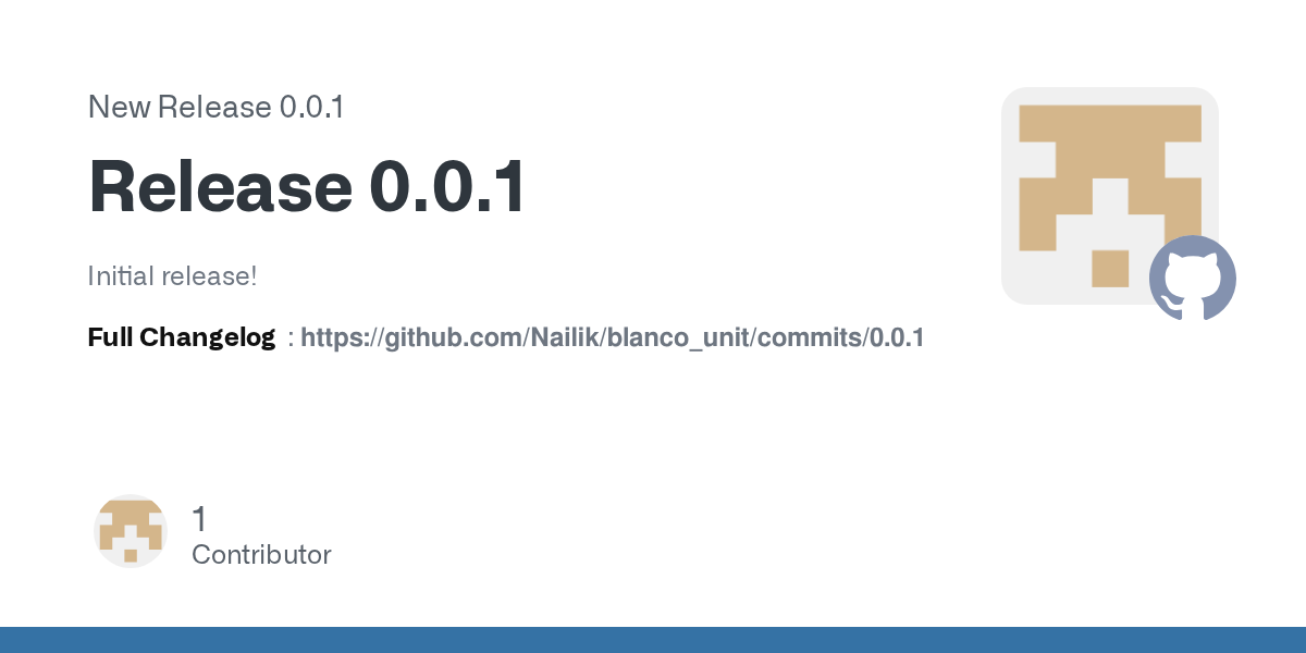

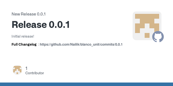

Initial release !
You can now test the first released version of my integration.

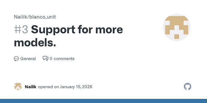

Currently i can not support hot water settings because i only have the drink.soda unit.
I’d be happy for anyone to give me data from the new models, therefore i created a small discussion how to get the data
