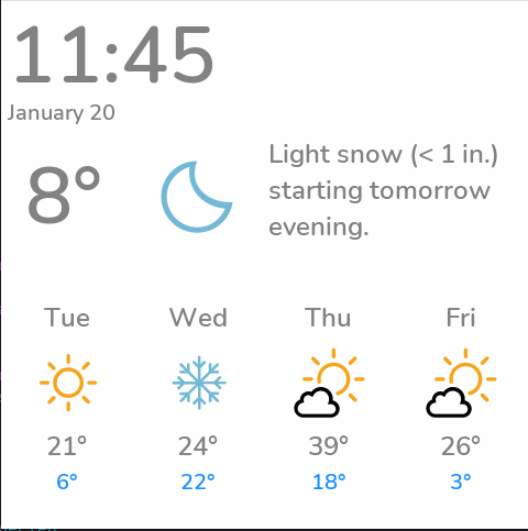

I got Accuweather working. It does have better data. I also made the layout a lot more complex and scalable.
weather
I just got the new “homeassistant.action” feature working with my weather system. Now I don’t need any edits to the configuration.yaml. ESPHome can now access the daily weather forecast directly from Home Assistant using homeassistant.action and a Lamda.
My code is all modular so you only need to add a few package files to your YAML code to get it working. It even builds all the svg icons for you.
Image on a 480x480 screen.
