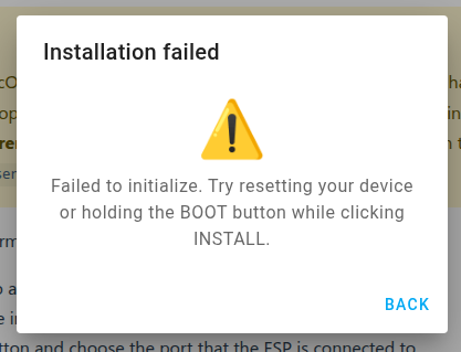

How do you successfully flash those things?
I keep getting errors “Failed to initialize. Try resetting your device or holding the BOOT button while clicking INSTALL.” but there’s zero information I can find about any “boot” button on them. Except the only button I can find is the “RST” button which seems to just reboot it.
Its also immensely vague which of the huge list of devices (that seems to be randomly-sorted) on the OpenMQTTGateway site to pick, I assume it’d be the Lilygo-rtl_433 since I want to decode stuff that is in the rtl_433 libraries but there’s no information and the few things I’ve guessed at all give the same error.
Getting very frustrated - any tips or should I return it and shell out for more Raspberry Pis and actual RTL-SDR dongles that work easily?
I don’t remember having to do anything extra, but you could try pulling GPIO 0 low by connecting it to a ground pin… that’s usually all the BOOT button does on ESP32 devices.
I used the Upload from the Web option with lilygo-rtl_433 chosen in the dropdown.
Ok, I just tried it shorting IO0 to Ground…and it looks like its in bootloader mode (LCD stays blank on power-up) but still no dice. I immediately get this message when hitting the install button.
Serial is clearly working though because whatever firmware it came with if I hit reset I can watch the console scroll.
Maybe I need to learn how to do it from a command line, I know the whole web-serial stuff is buggy as hell from trying to play with Meshtastic and ESPHome stuff. So much more reliable to just use a terminal than having the extra intermediate impossible to debug layers.
Update - FINALLY got it to work…apparently had to use Windows (specifically Windows 10) with Edge (not Chrome) and a USB3.0 port (yea even tho its a USB2.0 device) while shorting IO0 to GND.
Good grief what a painful nightmare!
