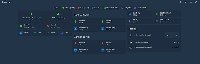

I can get the ‘estimated’ gas consumption from my boiler in m3 and can apply a 1.83kg/m3 for the propane. I’m looking to show the current gas level (using a 4No. bottle total and then deducting the daily gas consumption. This way, it will help me show when i’m down to one bottle etc.
Any ideas? I’d rather do this rough calc than buy any sensors that have been taken by the gas bottle delivery team before…
I don’t want to use a physical sensor, when I can get the gas consumption from the boiler… x 1.8 to get the kg. Just need a logical way of getting it to auto deduct from the ‘full’ value

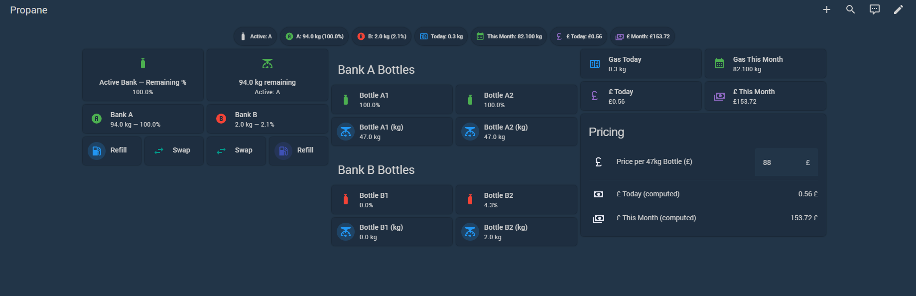

This is done by using the gas consumption from the boiler and converting to kg… deducting from the gas bottle levels. Just need to work on the tank graphic 0-100% for each one…
