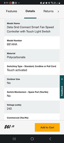

Newbie here again, I’ve been reading up on these fan Light switches and I have 3 which I’m about to migrate them all over to Smart Life and HA but I have a slight issue well 2 that a Newb like me can’t figure out what is going on.
