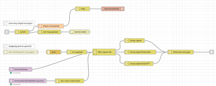

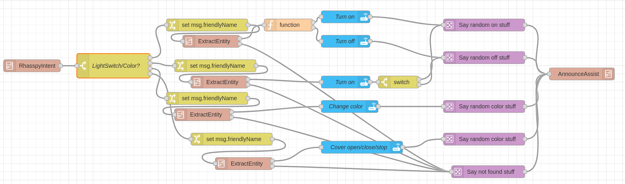

I managed to write a lot of glue code in Node-RED to bridge Rhasspy into Homeassistant. Node-RED was collecting all entities, filtered them and used Rhasspy’s api endpoints for training to make Rhasspy aware of them. I even built some magic to be area aware. If the satellite was in the “living room” and there was a “living room light” entity, it was enough to say “turn on the light” to only turn on the living room light. As Rhasspy also provided a lot of other api endpoints I also added Signal Messenger. I could write intents directly via chat or send a voice message that would be handled via Rhasspy for intent handling. My glue code Node-RED-Signal-Rhasspy-Homeassistant bridge would then handle it and call the right services in Homeassistant.
My Rhasspy Glue Code Magic:
Handling Messages from and to Signal Messenger:
Integration of Signal with Rhasspy/Hermes
