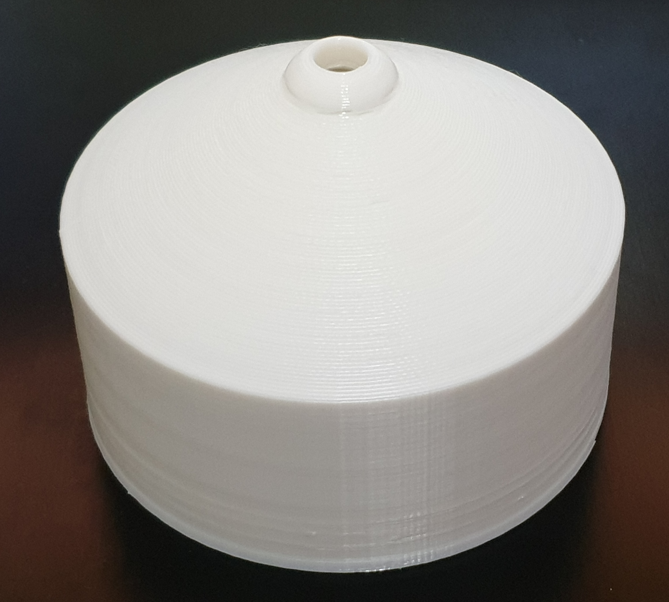

Basically I have added Eachen Smart On-Off mini’s (from Amazon) in each light that I want automated. The beauty of this is that you can leave your normal light switch alone, and mount this at the ceiling rose connection.
The problem of course is where to mount it; I didn’t want to cut a large hole in the ceiling so I decided to design a larger ceiling rose cover that will screw onto the existing electrical plate (I have the MK ceiling rose in my house) and give enough room for the switching box to sit beneath it.
Problem solved! Just print it on your 3D printer and voila!
If anyone wants to use it, it’s available on Thingiverse for download or Tinkercad for editing :slight_smile:
