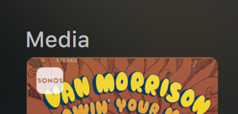

Thanks so much! With your trick what seemed impossible suddenly becomes childsplay, just made this svg icon (printscreen from my button):
Do you mind sharing the Sonos logo?
Just to save me some time
Sonos logo:
viewBox="0 0 50 50"><path d="M25.2,49.6l-13.65-.1a10.81,10.81,0,0,1-6.47-2.19A11.86,11.86,0,0,1,.8,41.13a27.31,27.31,0,0,1-.3-3V11.55A11,11,0,0,1,4.88,2.79,10.63,10.63,0,0,1,9.66.6a6.6,6.6,0,0,1,1.4-.1L27.49.4,38.35.5A10,10,0,0,1,45,2.89,11.11,11.11,0,0,1,49.2,9.46l.2,2.39.1,20.42-.1,6.67a10.42,10.42,0,0,1-2.19,5.88,11.58,11.58,0,0,1-6.77,4.38,11.08,11.08,0,0,1-1.9.2C38.45,49.5,25.2,49.6,25.2,49.6Zm2.23-23.94-5.27-4.94V29h1.57v-4.6L29,29.36V21.05H27.43ZM15.2,20.61A4.31,4.31,0,0,0,10.82,25a4.46,4.46,0,0,0,4.38,4.38,4.38,4.38,0,1,0,0-8.75m0,7.18A2.81,2.81,0,1,1,18,25a2.78,2.78,0,0,1-2.81,2.81M8.13,25a5.45,5.45,0,0,0-1.79-.78c-1.57-.45-1.57-.9-1.57-1.13,0-.44.56-.89,1.34-.89a3,3,0,0,1,1.46.45l.11.11,1.24-.9-.11-.11a3.86,3.86,0,0,0-2.7-1.12A3.45,3.45,0,0,0,4,21.28a2.24,2.24,0,0,0,0,3.59,5.42,5.42,0,0,0,1.8.79c1.57.44,1.57.89,1.57,1.12,0,.45-.56.9-1.35.9a3.24,3.24,0,0,1-1.46-.45l-.11-.12L3.19,28l.12.11A3.84,3.84,0,0,0,6,29.25a3.43,3.43,0,0,0,2.13-.68A2.34,2.34,0,0,0,9,26.78a2.53,2.53,0,0,0-.9-1.8M36,20.61A4.3,4.3,0,0,0,31.59,25,4.38,4.38,0,0,0,36,29.36,4.32,4.32,0,0,0,40.34,25,4.38,4.38,0,0,0,36,20.61m0,7.18A2.81,2.81,0,1,1,38.77,25,2.86,2.86,0,0,1,36,27.79M43,24.87a5.42,5.42,0,0,0,1.8.79c1.57.44,1.57.89,1.57,1.12,0,.45-.56.9-1.35.9a3.24,3.24,0,0,1-1.46-.45h-.11l-1.23.89.11.12a3.85,3.85,0,0,0,2.69,1.12,3.49,3.49,0,0,0,2.13-.67,2.25,2.25,0,0,0,0-3.6,5.36,5.36,0,0,0-1.79-.78c-1.57-.45-1.57-.9-1.57-1.12,0-.45.56-.9,1.34-.9a3.15,3.15,0,0,1,1.46.45l.12.11L48,22l-.11-.11a3.86,3.86,0,0,0-2.7-1.12,3.45,3.45,0,0,0-2.13.67,2.35,2.35,0,0,0-.9,1.8,1.67,1.67,0,0,0,.9,1.68" transform="translate(-0.5 -0.4)"/></svg>```
