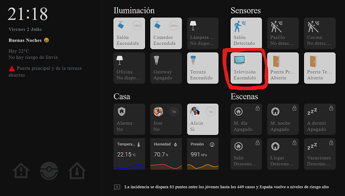

Hi all… someone have this error with TV icon???
