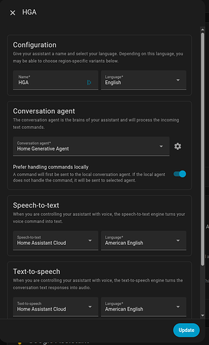

Hi, regarding the setup. You need to add Home Generative Agent as an assistant in Settings → Voice Assistants. My configuration is shown in the snapshot below. See the project’s readme for what you can do with it. You can also use the two provided blueprints to create automation that converse with the agent on a periodic basis, for example providing a summary of the home’s state with push notifications.
