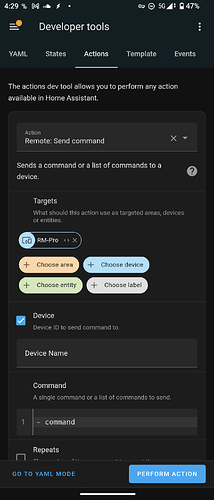

You can learn IR codes by directly calling the service in the developer tools section. I find that so much easier than writing a script. This is what it looks like in my case:
I usually just start with just one command and once that works, multiple together, like all fan modes, all temp settings, etc.
Keep in mind, that (most times) you need to be able to send the exact command, e.g. in order to send power_off, the device needs to be on before you start. Or in order to send “71” degrees, it needs to be at 70 or 72.
As a follow up to how I initially did this, I now just go straight to developer tools an remote: learn command and keep a one note record of what “device” and “command” I have learned, and use the call service option in automations and in the dashboard, not clogging up my scripts section. It’s a lot cleaner that way
I’m trying to use this feature with a Broadlink RM Pro, which allows both IR and RF controls. I’m a bit confused though. It appears the place to go is Developer Tools > Actions, from there, choose Remote: Learn Command, and choose the RM Pro as the device. Specify a device name for which device is to be controlled, then fillin a dash followed by each command name. This is where I’m lost. How do I tell the codes are actually learned?
Keep the names you have chosen and change to remote send command, you should get an led light up on the broadlink, there is also a file in your config folder that stores the commands
