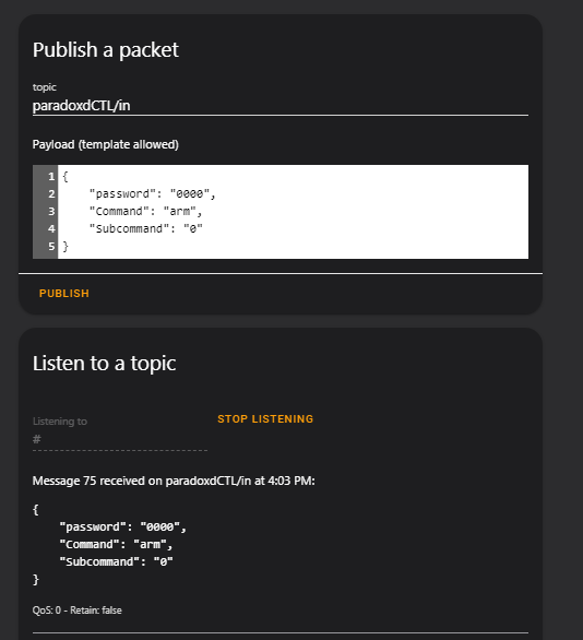

I get all the info from the panel, but canât control the panel⊠Does the Panel ID in the Paradox alarm have to be set to 0000? what about the panel password, also 0000? This I need to check but am away for work for a while (hopefully my girlfriend can check this for me) I never set these parameters before so figure they are still on default valuesâŠ?

I do whenever someone walks past a sensor etc, but not when I send the arm payload
donât you mean this is where you get the status feedback? to arm the alarm you still send to paradoxdCTL/in ?
Yes thatâs right
I have always received the status feedback correctly on âparadoxdCTL/Armâ and I get all the sensor data coming through from each zone, its just the arm/disarm I canât get to work on âparadoxdCTL/inâ. I still need to confirm the Panel ID and Password is correctly set as I didnât get a chance to do so last night.
I made sure the Panel ID and Panel password are both 0000 but it still doesnât arm / disarm via MQTT
do you see the command to arm the alarm in HA mqtt and it just donât accept it?
please post your config
correct.
I use the BWAlarm (this version) and since I am sending these commands via the Dev tool there isnât really any config involved.

What I sent it in the MQTT dev panel screenshot is the default configâŠ
I have tried all sorts of passwords, nothing seems to cause the alarm to arm
From what I can understand from the BWAlarm component, those MQTT parameters must be the incoming ones, not outgoing since Home Assistant currently (with the code I have above) arms / disarms correctly in sync with the Paradox alarm arming and disarming. The problem is that it doesnât work the other way, HA cannot successfully arm /disarm the Paradox system.
