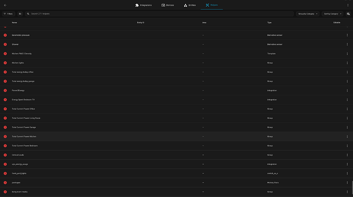

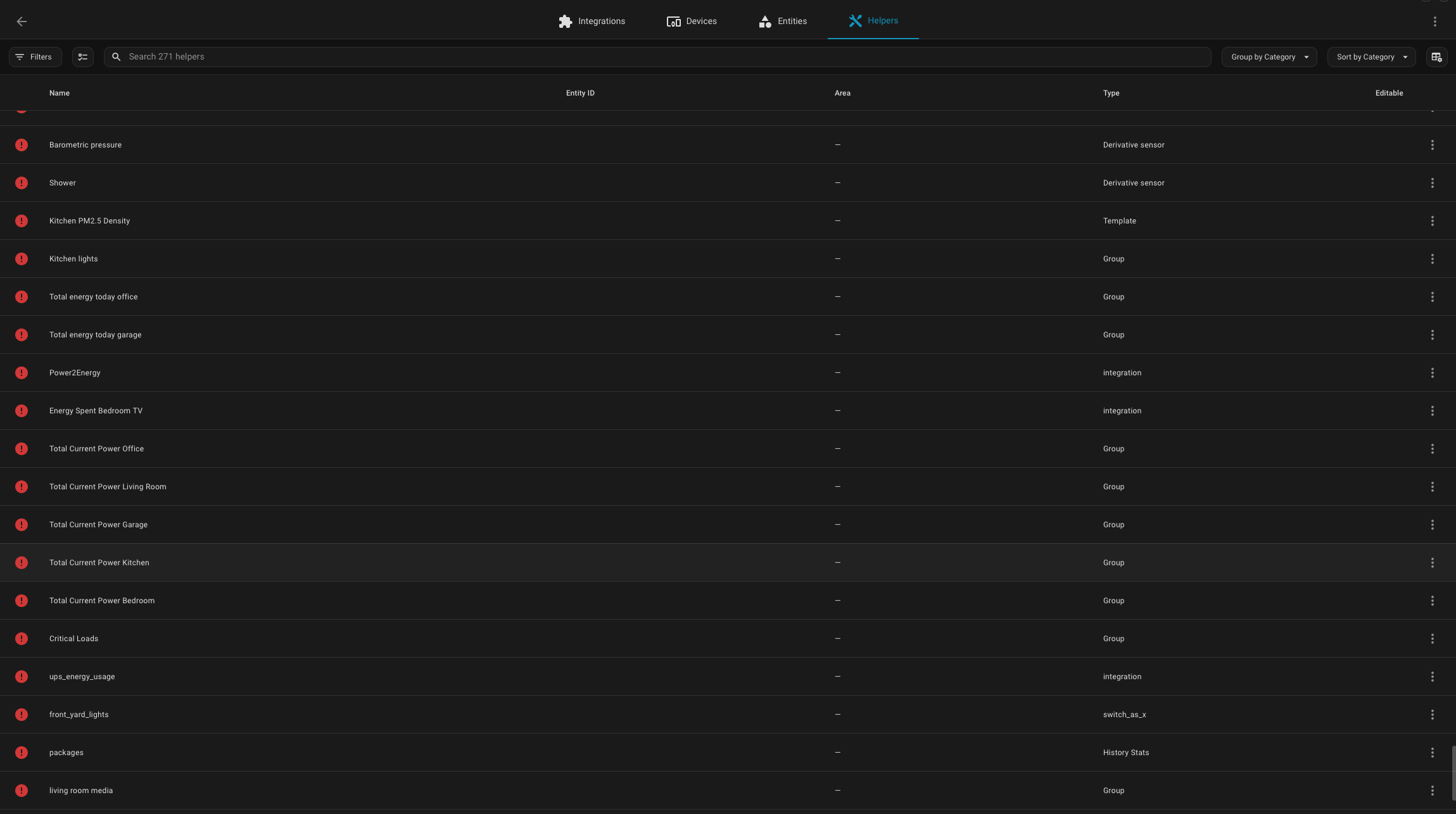

When I say “appear” broken, this is how my UI looks:
There is no tooltip with what the error is and when I click on the red thing I get the helper info but without the option to delete it:

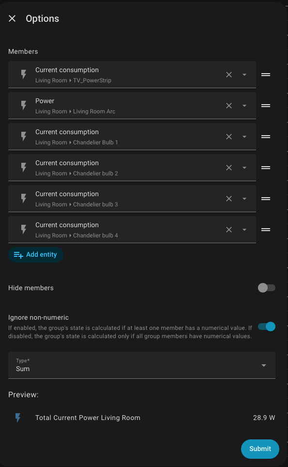

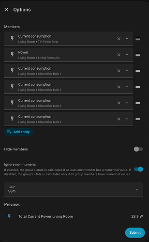

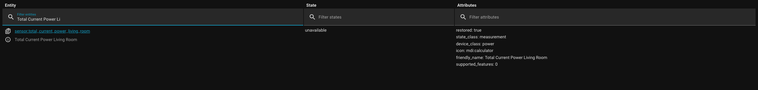

Interestingly enough, the “preview” does show the state / expected value. But the sensor itself is unavailable:
