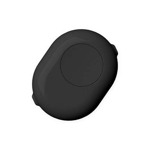

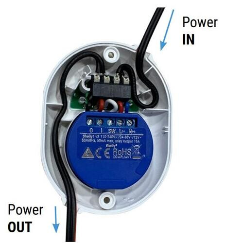

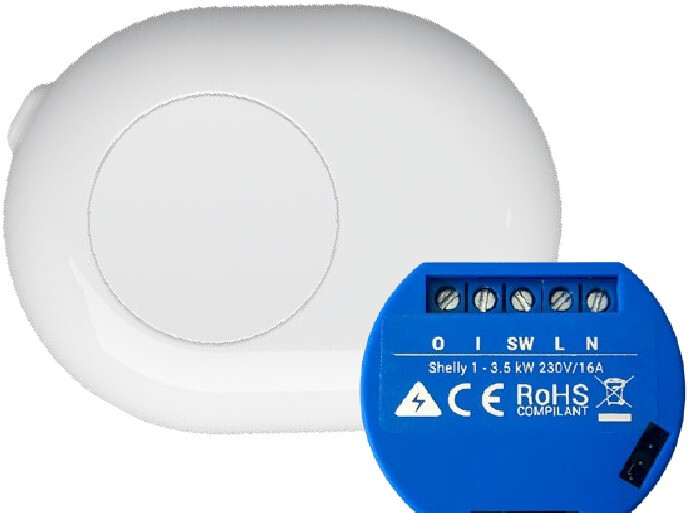

You could just use one of these to replace the in line switches you have with the lamps if they have it:
Damn. Looks like shelly no longer sell their lamp cord button.
Unless I’m missing it somewhere on their website.

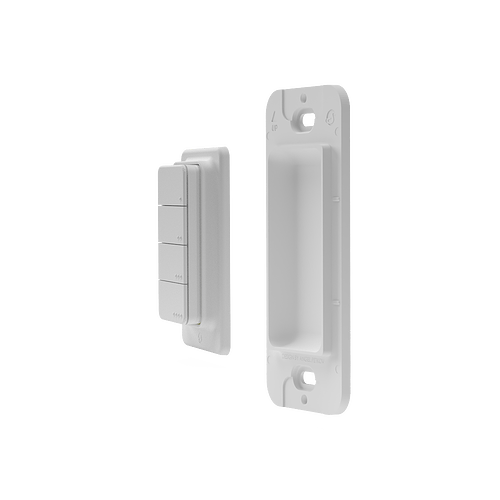

One problem is Shelly seems to only sell 4-button switch pads, which is annoying. A single or double would be better. I’m going to contact them and ask some questions about what can pair with their devices. If I can get any BLE button to pair, I’ll be able to use any button I can find.

It is still available
A few in black:
Mostly in white though:

I was looking at those, but they are not nice wall switches.
I am getting a bit frustrated with the industry about buttons and switches. It seems like manufacturers think all we want are key fob-like buttons. Those are OK if you want to carry something in your pocket all the time. But for actual in-home hardware, we need things that look, mount and operate more like the existing dumb switches.

No they go in the lamp cord. Is that not an acceptable solution to your requirement for the lamps?

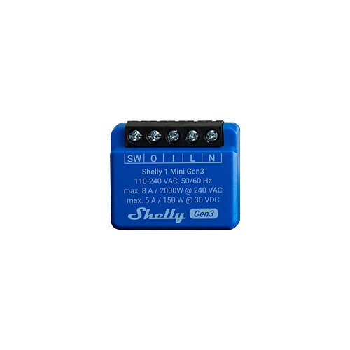

Many people use traditional dumb switches connected to Shelly (me included). Keep your existing switch or pick one that you like and connect it to any shelly device that has input. You need power though.
Like Karosm, I do this too with Shelly relays. As long as the box has power, you are off to the races. Any smart outlet that has an API endpoint (like the Shellys do), you can control. All local; no internet. Heck, you don’t even need HA to make it work. You can configure the relay directly from the Shelly app or its internal webpage.
