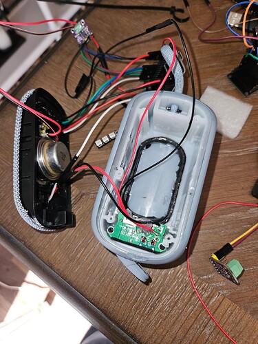

I took a $15 Bluetooth speaker from Wal Mart and made it into a voice assistant. Total cost was under $30
It has a small 4ohm speaker that pairs nicely with the Max98357.
Youll have to remove the battery and a PCB board. This will make room for the components. The board that has the USB input will stay as it has a nice 5v output right on top. You can just plug a USB-C right into the side as designed.

Add wires for ground and 5v(red and black wires of course)

Can you provide any hint on how to get the case open?
Take a small flat head screwdriver and wedge it between the speaker grille and the body. The speaker grille will sperate from the body.

Can you please provide a source, model, or description for the 3-LED board beneath the speaker grille/screen?
Amazon.com: KWMSTPLT WS2812B RGB LED Strip, Individually Addressable LED Strip, Chasing Effects Dream Color 5050SMD 3.2FT 144 LED Pixel Flexible Strip Rope Light DC 5V (Black PCB 3.2FT 144Pixels/m IP30) : Tools & Home Improvement
