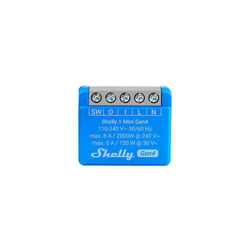

A shelly device can run in detached mode so the input is a binary_sensor and the output is a switch (or light). WIFI though, not aware of any zigbee that can do it

I’m not entirely sure I understood the question but I think a Sonoff zbmini r2 in detached mode will work for this application? You can set it to read the external switch state and let HA determine the state of the relay.
