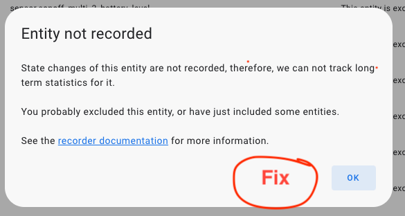

The problem is then, that there is no way to remove the statistics. In some cases, it is possible, like if the entity has been removed. Then we have a “Fix” button. But in the case of the entity being excluded, on purpose, then there is no way.
I have hundreds of these, taking up around 500mb of database (I actually measured just the statistics table using SQL):
When clicking “FIX ISSUE”, there is no option to delete the statistics. It is for some cases, like entity is missing, but not if the entity is excluded.
Proposal / feature request
- Make it possible to exclude sensors from statistics (yet still not exclude them from the recorder - sometimes it is good to have a week’s history of something but not keep it forever).
- In the case of an entity being excluded from the recorder, and prior statistics exist, show the “fix” button to remove the old statistics retroactively.
