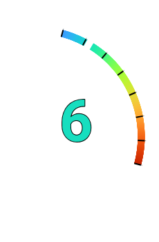

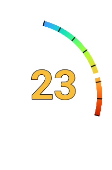

The final push for me was I spent a good deal of the weekend to create a gauge indicator in python with Highcharts package - see attached examples. Actually pretty happy with it (against a black background) with the ability to have variable min and max (based on min and max forecasted temperatures for the day) plus changing the font colour to align with the current value. Any way - indigo has been rock solid and feel I know my way around HOWEVER the control pages (aka dashboards) are simply too painful - so here I am.
