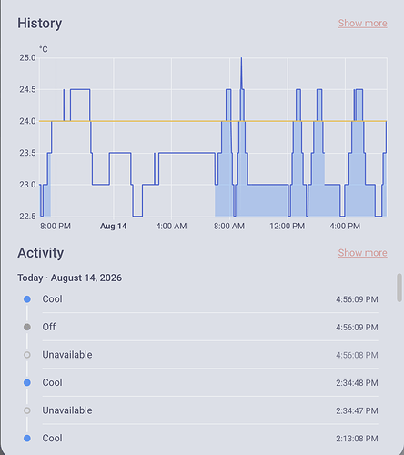

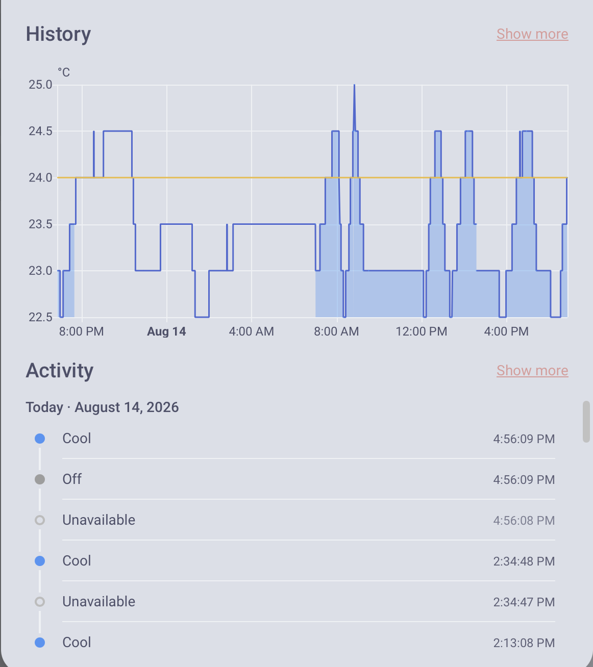

Here’s a screenshot for one of them but they both do the same thing.
You could remove the “unavailable” from your graph or simply not look at it. Less than 1s unavailability is likely not worth of investigation. If it bothers your peace of mind, try to catch the event on esphome logs.
Likely this connection drop as it is immediately followed by return to last state
You could add WiFi signal strength to sensors and see if that correlates to unavailable time. Send notification with last recorded rssi when it become unavailable or state changes to help.
