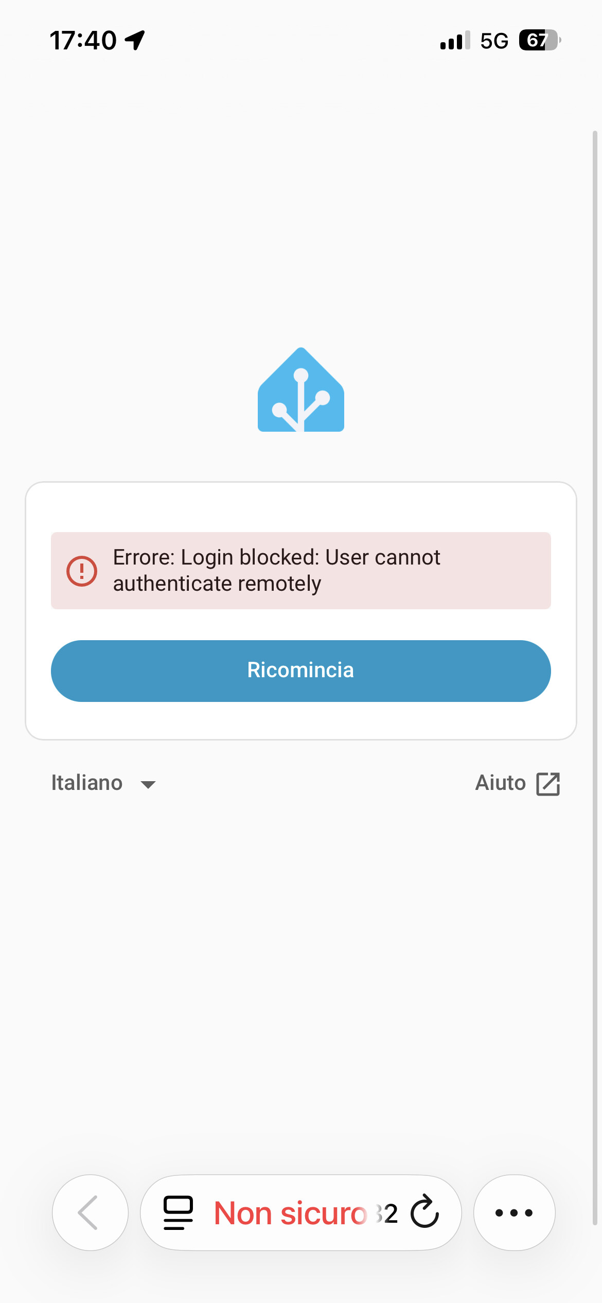

Hello everyone, I have installed tailscale and I can establish the vpn connection between the phone and home assistant. But despite me entering the correct credentials, home assistant refuses authentication. Do I need to activate any additional parameters?
Yes, you have to enable “remote access” for your User, in HA
/Settings/People#Users click the name of the user
Local Access Only, should be OFF
