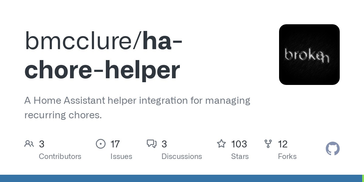

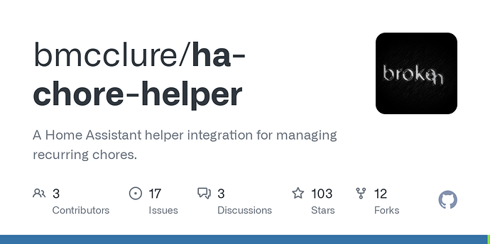

has anyone an idea how to set a date attribute with automation?
I’m looking a workaroung for chores. The update service doesn’t fill the date from ‘add_date’ to ‘next_due_date’.
So could anyone help with a template or so to add a date directly to the ‘next_due_date’ attribute?
It’s not about datetime integration. It’s about how to set a specific attribute to a specific date
Ah sorry, read it too quickly. Will delete prior message.
In general, you don’t set attributes unless the integration provides a service (action) for doing so. Certainly can’t be done with just “a template”.
What “chores” integration are you using?
It has a service for that purpose, it’s just not working. Or to be mor accurate… it has a service to add dates to a “temporary attribute” (even a list) and the update service should transfer the next date to the next_due_date attribute.
You can add the dates to the “puffer” but the update is not working properly and does’n transfer the next date to next_due_date.
