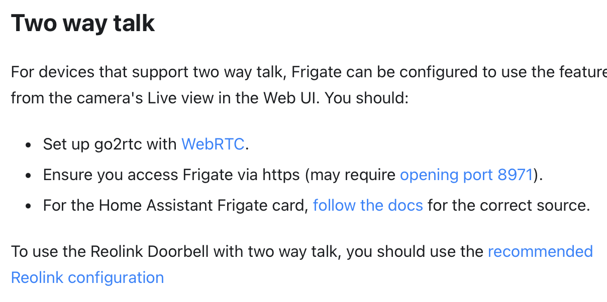

See (from frigate doc)
Is that a requirement? I don’t remember seeing that, but I don’t use audio with frigate.

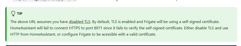

I am not sure, which certificates I am using. This topic is absolutely new to me.
I tried acessing frigate via the tailscale IPv4 and the magic DNS on port 8971. I tried with tls enabled and disabled in frigate config.
The 502 error appeared in home assistant, when I clicked on the Frigate icon in the side menu. I was able to connect to the same IP via the safari browser on my iPad.
In the logs of the frigate proxy addon, there are also some messages regarding a bad ssl handshake.
