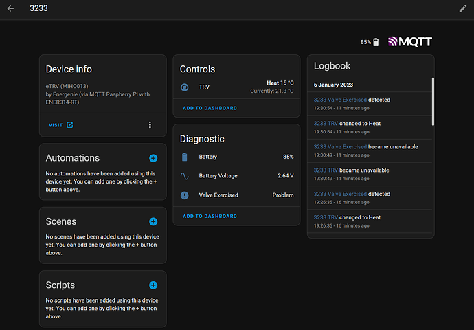

I am using your Node-red module to integrate into home assistant using MQTT discovery.

Energenie Smart Plug+ (MIHO005)
image image
