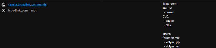

oh my … yes i clearly stated that this is seen in the template and IS the example of an array confirmation.
but when you query the state of the entity (in developer / states), both a string and array are shown the same.
