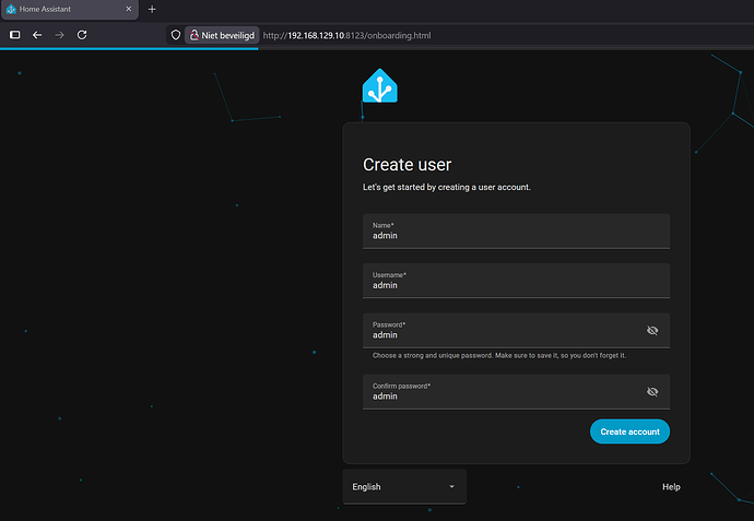

Hi all,
I’ve installed HA on my Synology via Docker Compose. When creating the account, I get stuck. Whatever I put, I can’t get past this screen.
When I searched on this forum, there were tips to put admin everywhere, to not use capitals etc, but this still does not work out for me.
I’ve stopped my project, deleted my ‘storage’ file andrecreated the project, removed the cookies/cache and used private browser with all my extensions turned off, still the same issue.
Can anybody point me to a possible solution?
Thanks !
Solved, there was another (failing) project of Home Assistent active on the same port.
