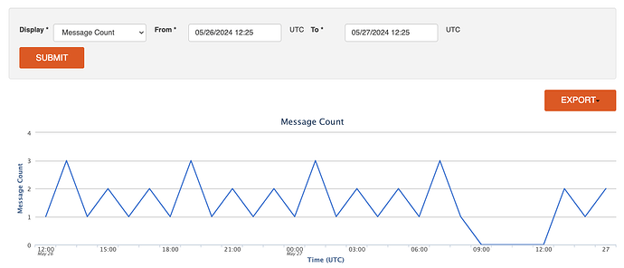

I’ve noticed a weird situation where the AccuWx integration data is not being updated each morning (local time) for a few hours. The graph below shows the stats from AccuWx API website (between 09:00 and 12:00 UTC) supposedly showing that either HA is not making these requests or they are not receiving them.
I don’t see any errors in the general log, and just turned on the debug for the specific module to see if there is anything useful there.
The integration doesn’t have any open issues, and I can’t imagine I would be the only one seeing this is if it’s truly happening for many. Plus I’m only using about 44 or so of my allowed 50 API calls per day according to their stats.
Anyone else have any ideas or seeing something similar?

I’m seeing this same issue as well, where in the morning at 7:30 AM it will not have updated for around 8 hours and thus shows stale data (including current condition as something like “Clear, night” and the previous day as the left most day in the 5 day forecast).
For my AccuWeather app at the developer site, I do see it shows “Country: United States” in the Details tab and my profile has the “America / New York” time zone as expected. Is there any other setting here that could be relevant?
What’s the easiest way to see if somehow I’m exceeding API requests? I would have thought that would reset at midnight, so a 7-8 hr gap of no updates after midnight seems suspicious.
So another quick update on this after I figured out how to turn on debug logging for the AccuWeather integration. I turned it on to track what happened from Feb 1 evening/night to Feb 2 morning.
For Feb 2, my Message Count graph in the AccuWeather App Analytics tab looks very much like the OP, showing regular activity each hour but then a gap of zero activity from 7:00 UTC to 12:00 UTC. This should correspond to 2:00 AM EST to 7:00 AM EST (my local time zone).
From the debug logs, I can that see the transition when the number of requests goes back up to 50 between the 8:35 PM and 9:15 PM requests. This seems odd as it is neither midnight in my local time zone nor midnight UTC, which would be 7:00 PM EST. Also note there is no indication that I’ve ever run out of requests or had a failed request.
