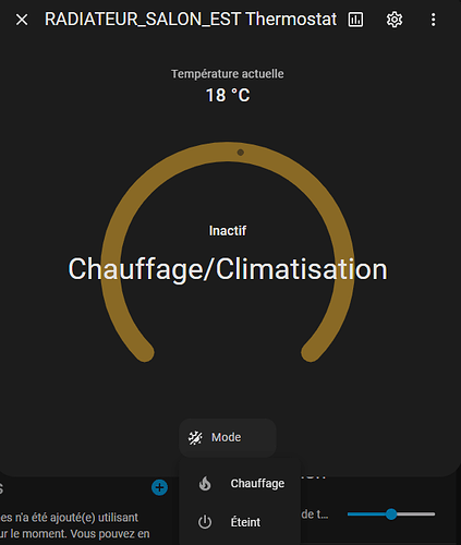

2 new heaters, one is ok, the second does not want to stay “available” on HA.
As soon as the lovelace thermostat card goes to “chauffage/climatisation” I can’t control it anymore
It seems to be an issue with the “idle” mode.
If the heater is in idle mode I cannot change the temperature anymore (but the heater is still connected to ZHA).
The heater is still in box mode but I can’t control it from HA.
And if I change the temperature of the heater (while still in box mode) it comes back on HA and I can change it again, but just for few seconds.
The probleme seems to be from the SystemMode.
If the Heater is in SystemMode.EmergencyHeating I can control it from HA without problem, but after a few seconds it goes back to SystemMode.Auto (which is the default BOX MODE on the heater) I can not control it because HA is blocked on this Heat/Cool.

Hi everyone!
There’s something amazing following the last update (or even before but I hadn’t checked).
I have one of my radiators which now has more options and I can apparently control it correctly.
In the modes I now have ‘Heating/Cooling’ and it seems to work.
But the others don’t have all the options:
I’ve tried ‘reconfigure’ but it doesn’t change anything.
Is there a solution to get the same thing?
These are the same radiators, bought at the same time.
And in the development tools I see this:
The good radiator: hvac_modes: off, heat_cool, cool, heat
The others: hvac_modes: off, heat
Edit : I also tried to remove and add again a heater but still the same missing features.
