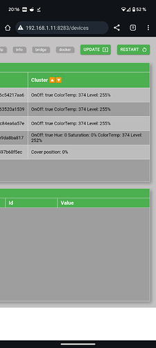

I’m running the latest of everything but I have a problem that my dimmable lights only show up as on off lights (but with temp control) and from the bridge ui I see the type is ā€œMA-colortemperaturelightā€. Not sure if I’m missing something that is configurable to get it working?
Ok, thank you :slight_smile:
Follow up on my own question, seems to be the level = 255% is not working.
Here is when I turn lights to 100% in home assistant:
If I lower to 99% it workings on Google home and says 99%, but 252% in the bridge ui:
Then if I increase to 100% in Google home it shows up as 254% in bridge ui:
okay. First of all, it’s not percentage - obviously. :joy:
It’s a value between 0 and 255. That’s a visualization bug in matterbridge. Anyway… matter does not accept a value of 255. 254 is the maximum allowed value. I thought Iā€˜ve considered that everywhere. But maybe I forgot one edge case. I’ll have a look at that tomorrow.
