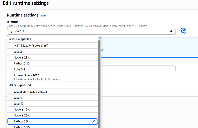

I just got the same. For those that set this up forever ago and dont really mess with AWS much, here are some simple update instructions from my perspective:
  1. Login to your AWS console.
  2. Under the 3 horizontal lines (Hamburger button) on the left, click on ALL SERVICES then click on LAMBDA which is in the COMPUTE section.
  3. Validate you have the correct region you are running your service in the upper right part of this page, then click on the Hamburger button on left and select FUNCTIONS.
  4. You should now see your function you created here and click on its hyperlink to get to your function.
  5. Once on the function screen, scroll down until you get to the “Runtime settings” section, then click Edit.
  6. Choose the Python 3.12 runtime and click “Save”.
  7. Done.

I just got a notice about this - presumably updating Python doesn’t affect anything else right, just change to 3.13?

Worked for newer versions as well now that 3.9 was end of support. I upped to 3.14 (feb 2026 current latest) and it worked great. I’ve been using HA for a while now but create my community account to say thanks for this info!
