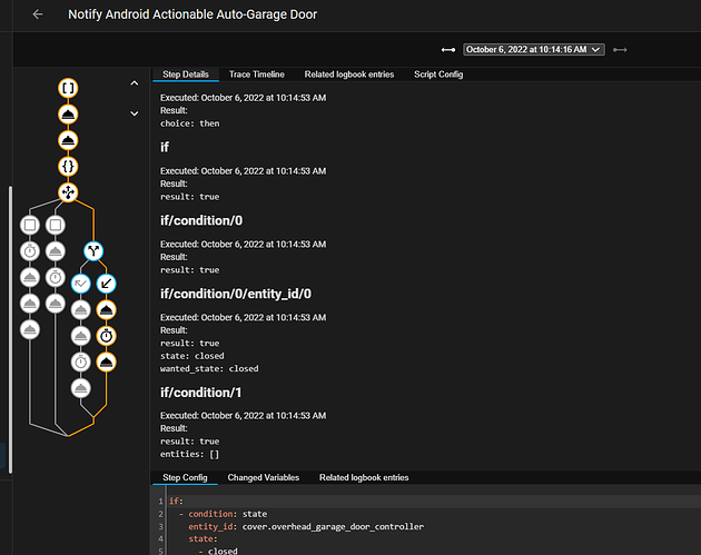

Hi all,
I’m having a couple of issues with an automation that automatically opens my over-head garage door. It will open my garage door under these conditions:
- I press the open door now button within 4 minutes of being close to home (i.e less than 1.5 km)
- I arrive home home within 4 minutes (i.e. my phone connects to my home wifi)
Problem is:
I added some conditions in the “if” part to check to see if the garage door is already open/opening before it opens it…but having that condition leads to the else action of cancelling the door opening, even though the garage door is closed and no action was taken. I’m not sure why or where to put the condition to check if the overhead garage door is open/opening right before then call service send the command to open the overhead head garage door. I do not want the command to be sent if my overhead garage door is already open or opening.
On timeout scenarios, there are errors that are logged related to this. Not sure why these are showing up:
Logger: homeassistant.helpers.template
Source: helpers/template.py:535
First occurred: 8:18:06 AM (2 occurrences)
Last logged: 8:18:06 AM
Template variable error: 'dict object' has no attribute 'event' when rendering '{{ wait.trigger is not none and wait.trigger.event.data.action == action_stop }}'
Template variable error: 'dict object' has no attribute 'event' when rendering '{{ wait.trigger is not none and wait.trigger.event.data.action == action_open }}'
Here’s the automation and script:

any ideas what is going on? thanks for your help.
