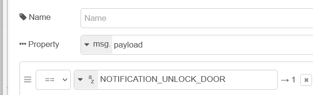

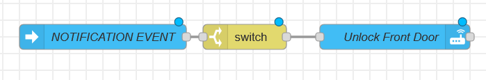

I then have a node listening for mobile notification events and sends this:
$outputData("eventData").event_type
to a switch that unlocks my door if the value is NOTIFICATION_UNLOCK_DOOR

What am I missing with my event and switch nodes then?
I changed == to contains, but it still doesn’t work.
You are using the wrong property in the switch node, you need payload.event.action.
