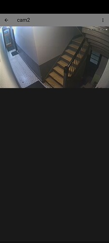

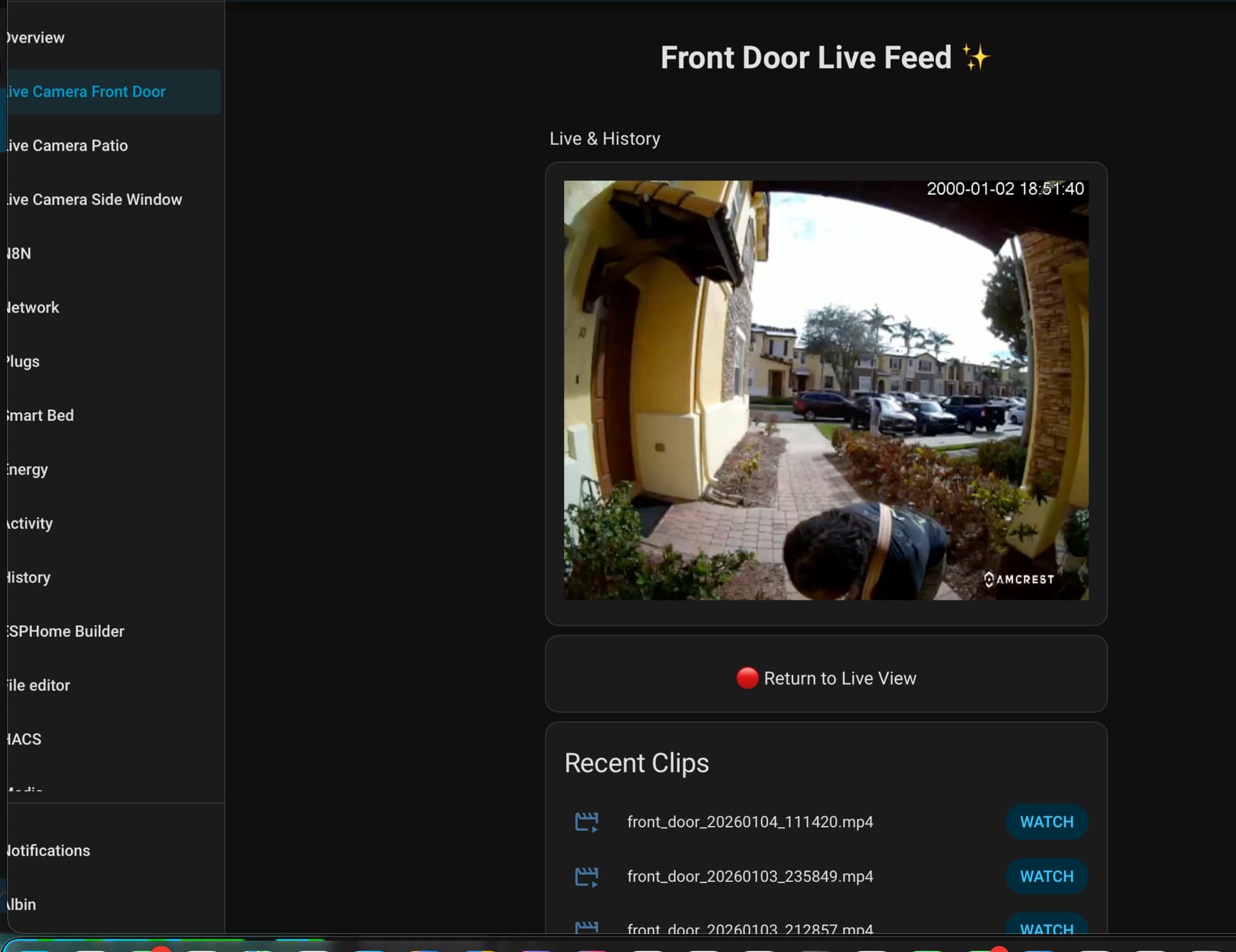

after much struggle i made this from scratch the video tag and the picture in a glance card
