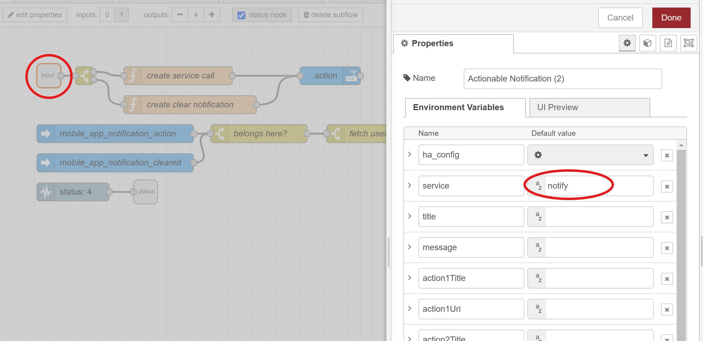

Indeed with new version of node-red/HA you need to use “action” node instead of call-service node. In addition you need to use “notify” sevice nowe so to make above flow working with new red-node/HA you have to change “input” and set “service” environment variable to “notify”. See screenshot (it helped in my case)
