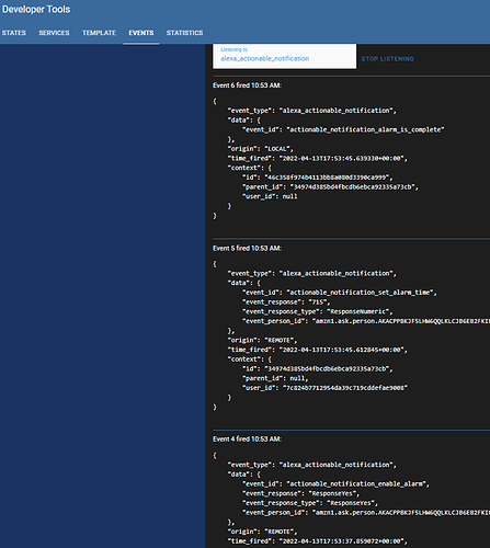

Thank you for the reply!!! Can you tell me where I am going astray?
In Developer Tools I get UndefinedError: ‘trigger’ is undefined.
In my Automation, I know event_response_type: ResponseNumeric is triggered because I have it toggle a light I can watch… But nothing I can see past that. Ideas?

That template will return true or false. You will want:
value_template: '{{ trigger.event.data.event_response }}'
In Dev Tools, Events you will want to START LISTENING to alexa_actionable_notification

I was finally able to get a response from developer tools - Events… Not as documented as the other tools… BUT, I see what you are talking about and played with various test automation… MY findings… I am able to (In the Trigger: section) add the event_response: and if that number is used, the automation is triggered… I am now ½ way there thanks to you :smiley: … Currently with the new knowledge, I am able to use that number in the trigger, but I am not able to save the number in the action: section. Do you think that is because it is automatically dismissed after trigger is activated?
No, the trigger variables remain available throughout the duration of that invocation of the automation and will be available in the action: section. Post your automation code and let’s have a look…

    data_template:
      value: >-
        {{ trigger.event.data.event_response| int(default=0) + states("input_number.coffee_filter_count")|int}}
  - service: notify.alexa_media_last_called
      message: >-
        You now have {{ states("input_number.coffee_filter_count")|
        int(default=0) }} coffee filters.
        type: tts
  - service: shopping_list.complete_item
mode: single
I just tried this but failed to get ask home assistant actions simon says do you want me to set an alarm for you eventid is alarm_time to work. She does not know what I am talking about…
works! :beers: Previous attempts like
did not work.
… BTW :thinking: I would bet there is only a hand full of users that have successfully installed the skill and very few of them do like we do and have a response invoke another question! I absolutely thank you for taking the time to guide me a solution… As mentioned previously, I was never able to get the Developer Tools - Events to do anything… then all the sudden I saw the capture like you shared… :slight_smile: Have a great day & keep in touch!
I did not check your original coding against mine thus did not notice data_template: value: should have been data: value_template! I was focused on the template itself {{ trigger.event.data.event_response_type == "ResponseNumeric" }} which was incorrect. Sorry about that.
Dev Tools - Events: I too was a little dumbfounded when I first went to that page!
