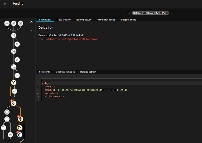

Hey this might help future people as well, I’m getting these errors. I assume it’s because I don’t know how to properly write the mobile notif service.
I tried to pull what was shown in HA for built in Notification Action.
“The automation “Remind (Water the Succulents)” (automation.remind_water_the_succulents) has an unknown action: service.mobile_app_sm_g965u.”
Q

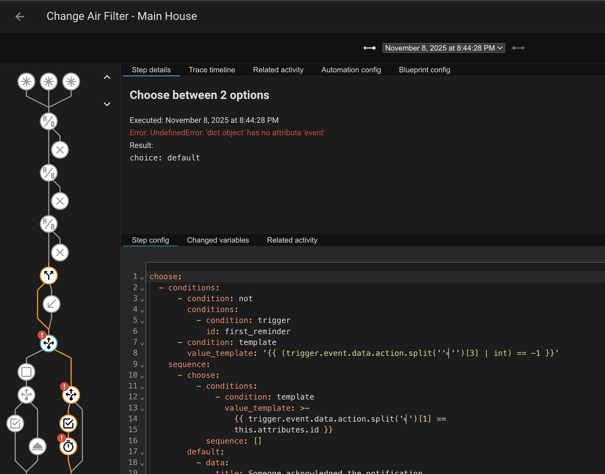

Not sure what I am doing wrong, but whenever I try to run/test it, I get this error:
Same here… getting the same error.
Anyone have a working example or know how to get past this error?
Here’s my code… just trying to get a notification to kick off first then will expand out on details
alias: Change Air Filter - Main House
description: ""
use_blueprint:
  path: sisimomo/actionnable-task-reminder.yaml
  input:
    notificationTitle: Change Air Filter
    notificationSubtitle: Furnace - Main House
    notificationBody: Time to change air filter
    notificationService: notify.mobile_app_fireheadman13m
    startDate: "2025-11-07"
    reminderTime: "20:44:00"
    everyXDays: 1
    stopDate: "2025-11-06"

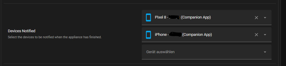

@mrwogu Can you maybe add a GUI based popup to select the devices or maybe person?
Like that multiple would be also nice:
