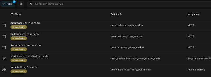

Entities are part of the label:
I Have no clue why. Maybe a bug concerned the newly introduced label system?

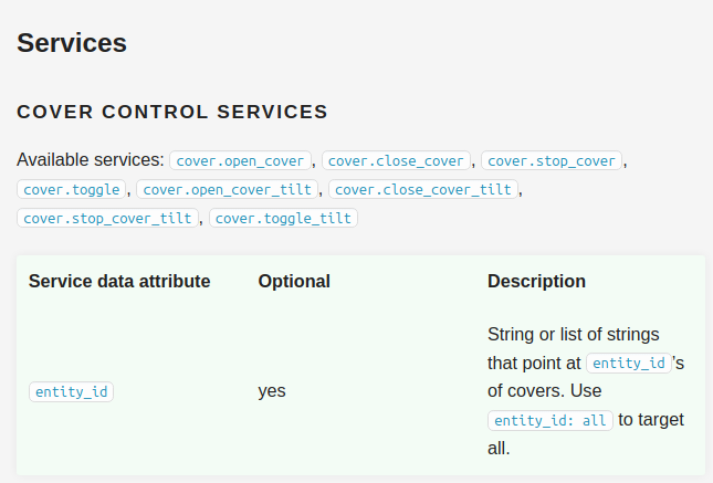

The docs don’t say you can use label_id in the target, so not a bug. Maybe a feature request…
Few, if any, of the services docs have been update to include the fact that they support “label_id”… in fact, there are still a number of core integration docs, like Light whose Services section don’t even directly mention the use of target, let alone the ability to use it to target areas, devices, or labels.
You’re right. That’s poor, but expected I guess.

As @Troon says, you have different types of entity with the same label.
In your screenshot there are three cover entities, one input_boolean and one automation. The service…
          - service: cover.open_cover
            metadata: {}
            data: {}
              label_id: suedseite
is not going to work on two of them. They are not present in the automation which you say does work.
You can give the same label to a mixture of, say, lights, switches and input_booleans provided you always use the homeassistant.turn_on service, but I don’t think open_cover is ever going to work with the automation entity, is it? :thinking:
I understant your point, but i would expect, that HA only hands over the items, which cover.open_cover can work on. In this case only covers. And obviously it does, because one of the three covers is actually reacting.
Other indications, that its intended to work like this:
  • if you want to add labels to the cover.open_cover service in the visual editor, it only shows labels, which point to covers
  • if you have selected a label in the cover.open_cover service in the visual editor and you click on the two arrows shown on the label (<>), then it expands and shows the right three entities
