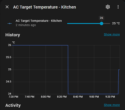

I almost got it to work. The number helper gets updated when the AC target temperature changes. But I am struggling to use the “Action on set value” option to udate the climate component whenever the number helper’s value is changed by a user.
E.g., if I set the value to 26, you can see that the tool tip indicates that I have set it to 26, but the actual value remains at 25:

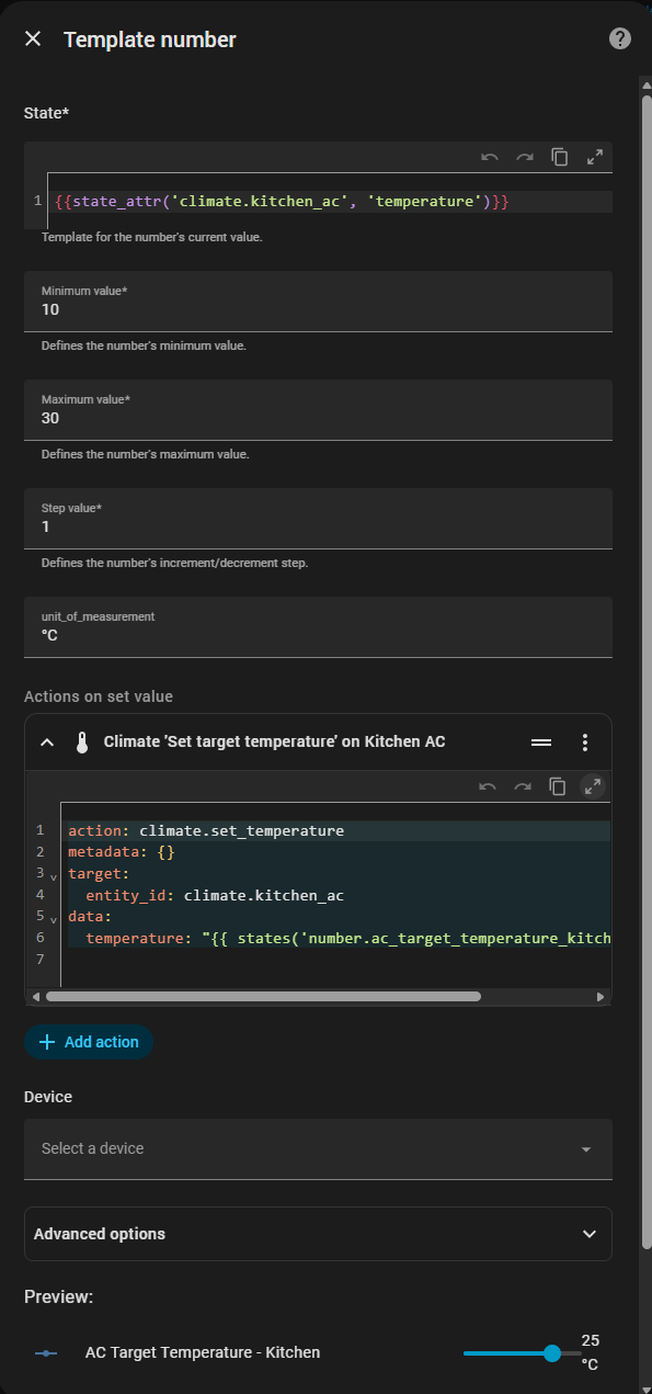

Here is the implementation of the “Action on set value” in the helper:
The complete yaml code of that field is:
action: climate.set_temperature
metadata: {}
  entity_id: climate.kitchen_ac
  temperature: "{{ states('number.ac_target_temperature_kitchen') | float }}"

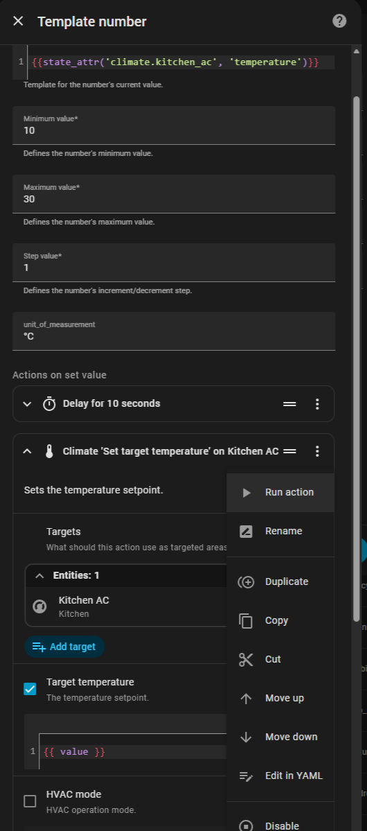

What’s the equivalent in the number helper case? I tried {{ value }} and {{ number }}, but those don’t work.
Any help is appreciated. Thanks in advance!
{{ value }} is the one. What’s the value of your hvac_mode?

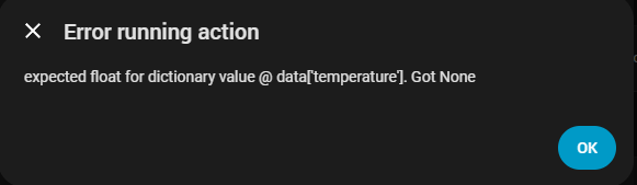

I had tried {{ value }} before … but I kept getting the following error message:
I now realise that the reason for that error message was that I tried to test the code using the “Run Action” menu - but that one wouldn’t have a value because I didn’t actually change the value immediately before running that action. :man_facepalming:
