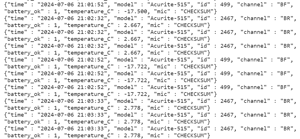

The logs in RTL_433 show that the sensors are updating properly. The times and temperatures are changing (see below). But notice it only shows the temp in deg C, not deg F. (This will be important later.)
