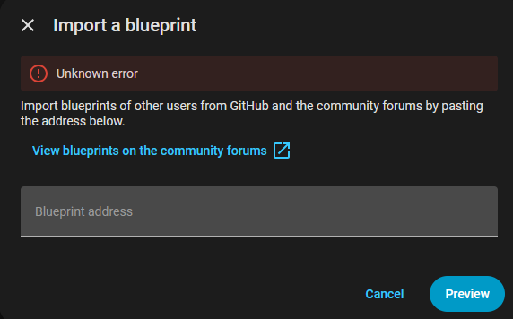

Import fails with an unknown error:
The Blueprint address is removed following the attempted import.
@Orange-GT3 Thanks for letting me know. I will test it and get back to you shortly.
@Orange-GT3 thanks once again. It was an indentation in my YAML that caused the problem. Can you test and let me know if it imports?
