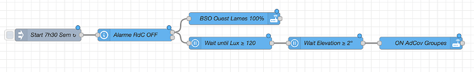

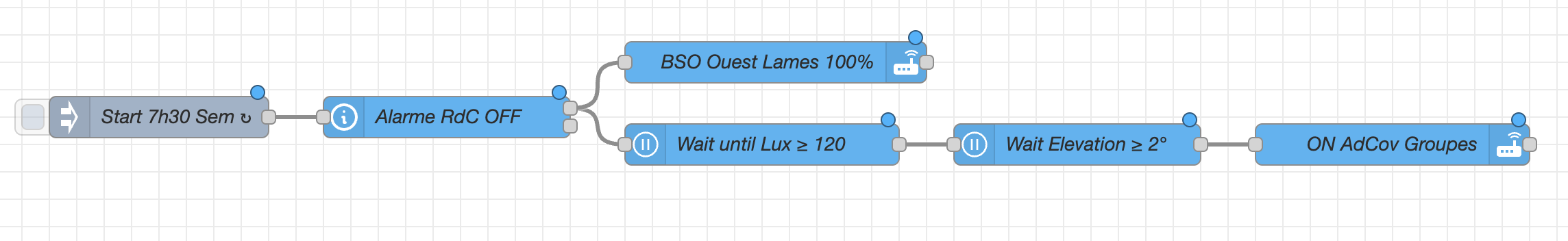

I manage the lauch of Adaptive Cover with Node-Red too.
Here is a part of an exemple of nodes
Hope I respond your answer
