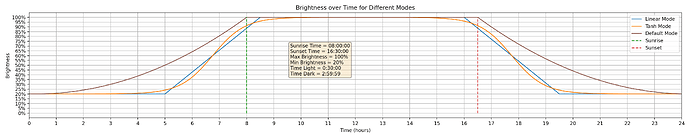

Adaptive Lighting (credit: basnijholt) -- effect of min_sunrise_time

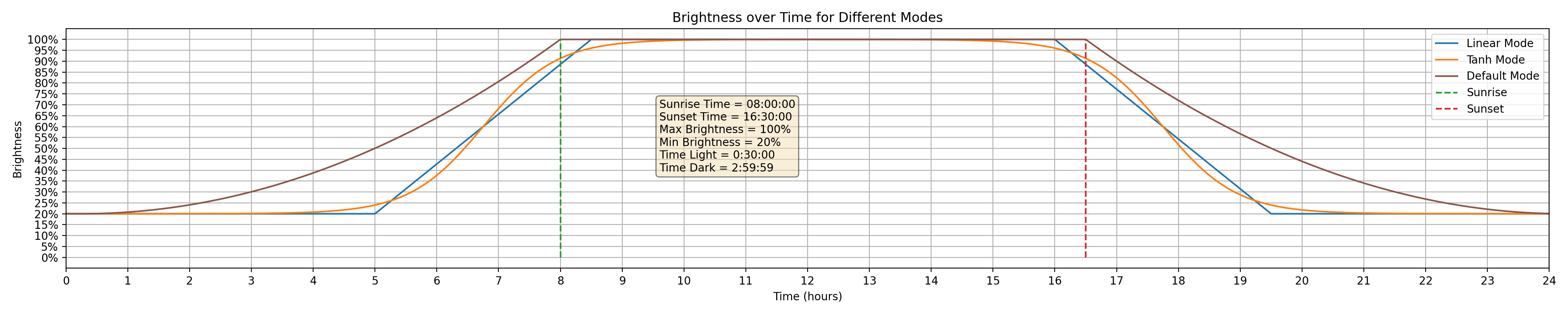

Specific example. Sunrise this morning where I live was 08:04am local time. I ran a simulation as follows:
  • Sunrise 0800
  • Sunset 1630
  • Max brightness 100%
  • Min brightness 20%
  • Time light 30mins
  • Time dark 3hrs
See the curve for this.
My question is simply this: if I set min_sunrise_time to 0600 (the new “virtual sunrise”), does my curve look identical in shape but just with the sunrise phase left-shifted as if the real sunrise were 0600? Or does it do something else?
